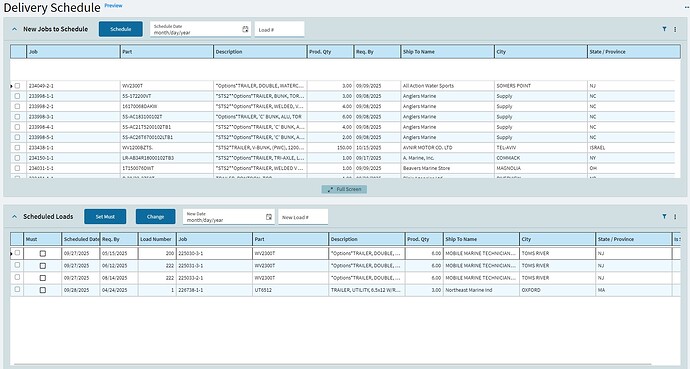

This is a screenshot of where I’ve gotten so far for reference. It is essentially two panel cards that have the grids filled by two seperate BAQs. I have gotten as far as making both grids selectable, added the relevant buttons, etc. However the properly how to create the action onclick for the button is where I am getting lost.
So referencing the above photo, what I would like to do is whatever rows are selected within the grid when the Schedule button is clicked. It writes back to Job_Head.Date06 of each selected row, the value that is entered in the datepicker(DatePickerSchedule), and to Job_Head.Number01 the value that is entered in the textbox(TextBoxLoadNum).
