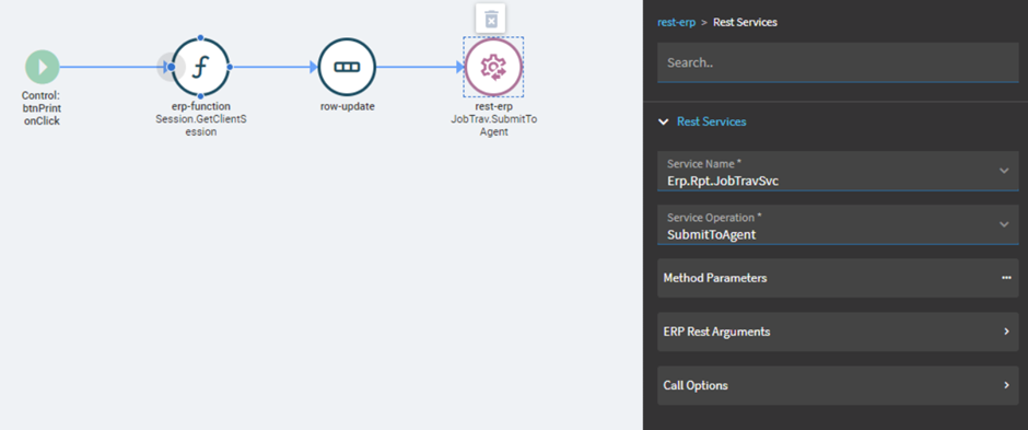

Option 2: Calling the report svc to submit via task agent (In this example I’ve done it with the Job Traveller)
I created a re-usable function to retrieve the client workstation (clientcomputer name + username) then pass this variable into a TransView.WorkstationID filed in the row update.
Thereafter it was just a mapping exercise to populate the dataset in method parameters (These essentially will be relatively similar to the parameters in you auto print configuration widget but for the quote report). – You will be able to test this via the Rest API Helper

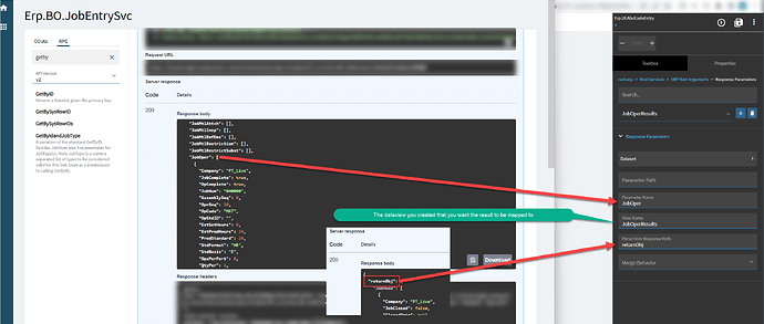

Please find screenshot below as a quick visual example regarding parsing the response from a rest-erp widget using the rest helper to get an idea of mapping the returned dataset from the rest call to a data view.
After updating the WorkstationID from the function, I try to map the JobTrav JSON. However, I still have no luck getting a preview to launch from the SubmitToAgent.
Is there an extra step to get the preview to launch? Or am I simply mapping the JSON improperly.
