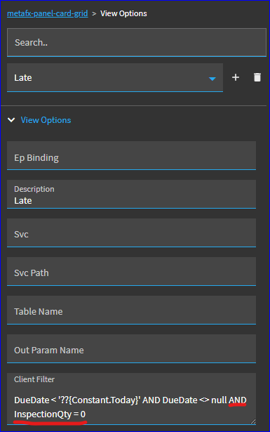

On the buyer workbench under late PO’s, it shows PO’s being late that have been received into inspection. Is there a way to stop this from showing as late on the buyer workbench, the parts are here there just in inspection
Yes, you can just add to the Client Filters for that particular View Option.
The Client Filter is what is going to show under the particular “View”. So, if you add AND InspectionQty = 0 to the clause, any records where InspectionQty > 0 will no longer appear in the view.
