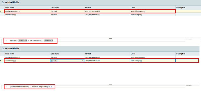

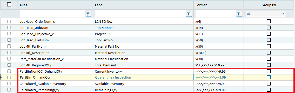

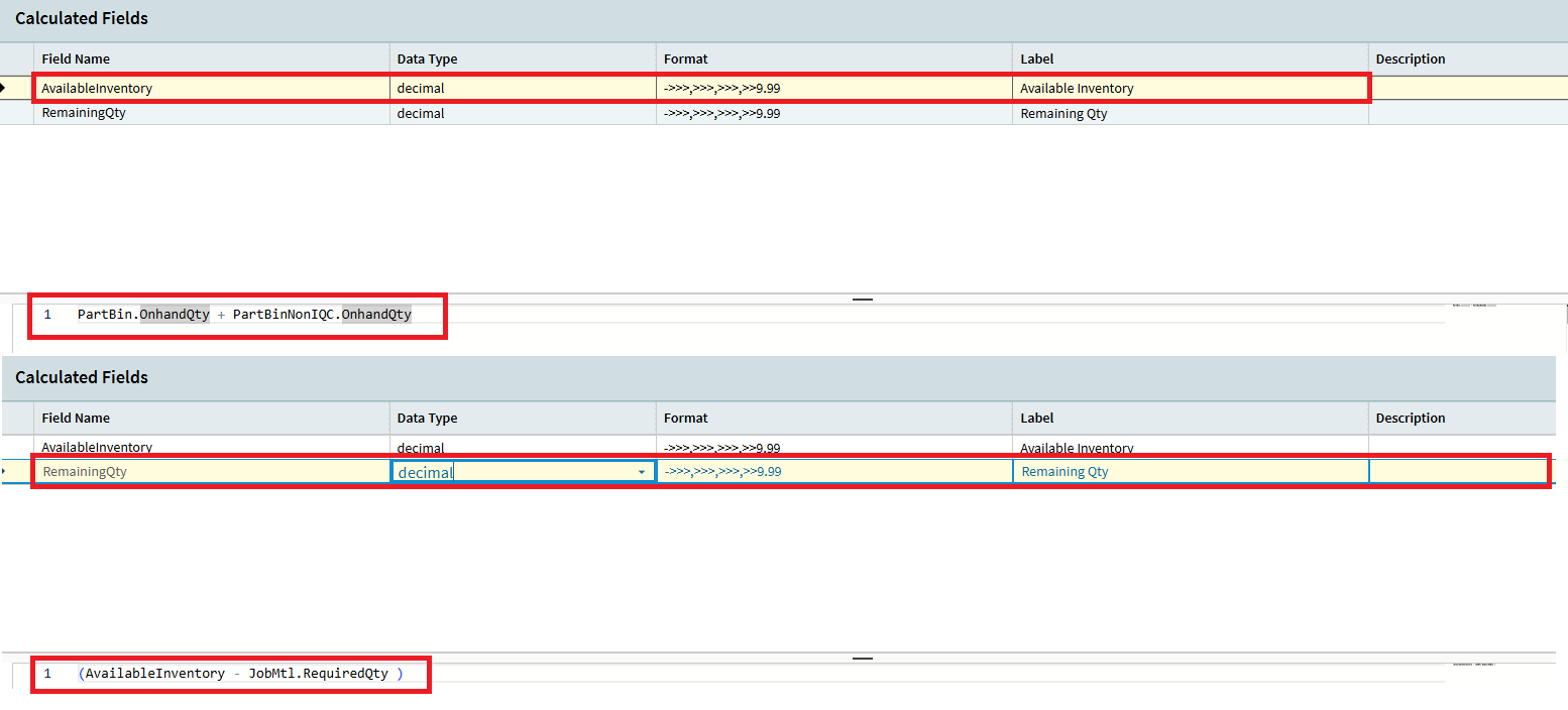

I am scratching my head on how to correct this. I have a BAQ that I have written that is pulling on hand data from PartBin.OnHand Qty per below. Current Inventory (PartBinNonIQC_OnhandQty) + Quarantine / Inspection (PartBin_OnhandQty). Then I have two calculated fields to show Available Inventory and Remaining Qty:

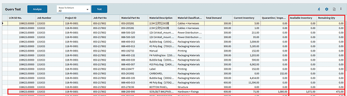

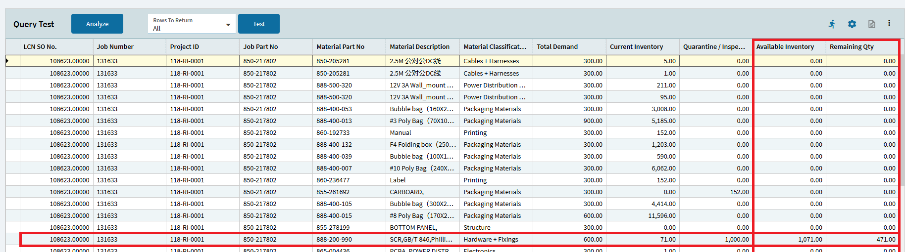

However you will see in the results below that the calculation will only work correctly IF there is a value in all fields - like the row below:

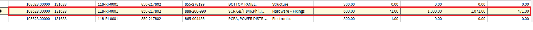

However the row below that should be returning a value of 1 for Available Inventory and -299 for Remaining Quantity.
I did search and found a topic that suggested it might be a type issue and to try updating the calculated field to below as an example for Available Inventory:
CAST (PartBin.OnhandQty AS DECIMAL(7,2)) + CAST (PartBinNonIQC.OnhandQty AS DECIMAL (7,2))
But alas that didn’t work either
I have spent way to long on what I would have thought to be a simple task so I am turning it over to the Brains Trust.
Much Appreciated
Angie
Have a look at the ISNULL() function. Try something like:
ISNULL(PartBin.OnhandQty + PartBinNonIQC.OnhandQty, 0)
Also try:
CAST(COALESCE(PartBin.OnhandQty,0) AS DECIMAL(7,2)) + CAST(COALESCE(PartBinNonIQC.OnhandQty, 0) AS DECIMAL (7,2))
