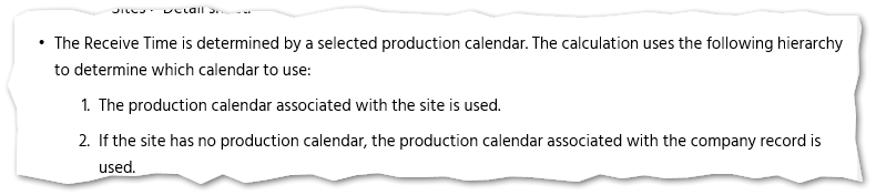

The MRP Technical Reference manual gives a pretty good discussion of both the Production Calendar and also how Days of Supply value is used. I don’t know if there is a single document that tells you everywhere the Production Calendar is used.
I didn’t find it helpful. It doesn’t tell me if the the Days of Supply is looking at Calendar Day or Production Calendar. We are finding that not everything is reading the Production Calendar.

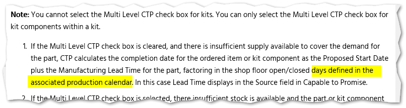

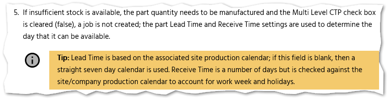

Is CTP the same as Days of Supply?
We don’t use MRP, so I don’t know. Only, guessing that CTP stands for “Capable To Promise”
