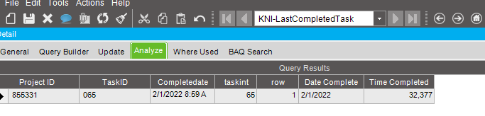

Did you try and run it by hard coding some values. Just to make sure the call is working?
Does not work by setting the parameters to hard coded values in the code. I also checked using the info message to see if the parameters are set, and they are (using hard code and using the datatable values)
do you mean hard coding the BAQ and removing the parameters?
The BAQ call was working and returning data when it was only 1 parameter. It stopped working when I added the second one

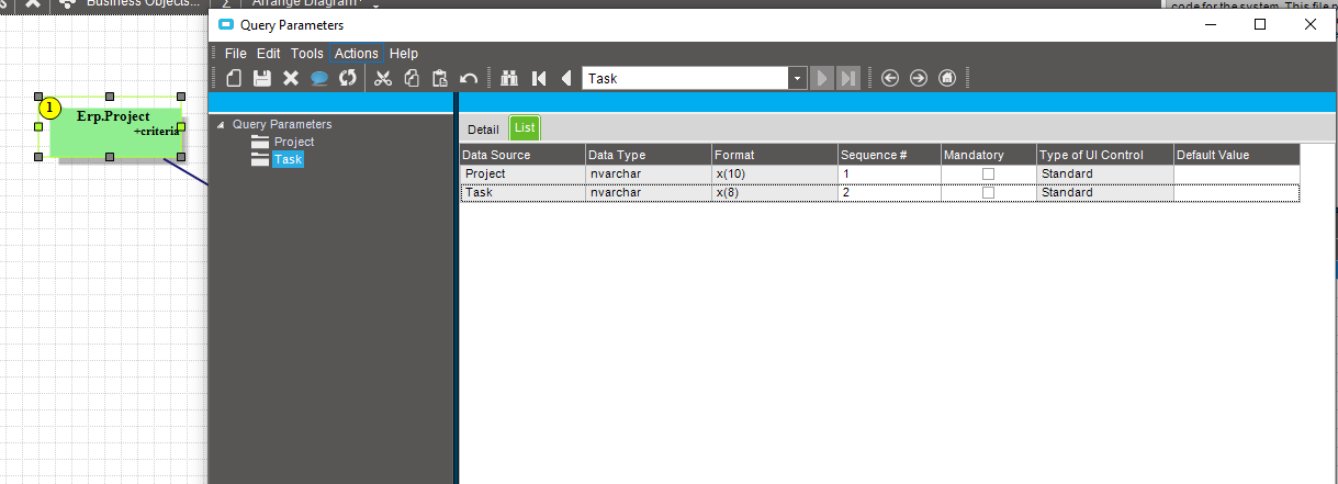

What does the BPM code look like now? Please post the whole thing. vs just the param code.
Can you also show the parameters from the BAQ. Something is weird here.
I meant to hard code the BPM code so its using values you know that will return something vs using vttprojecttask.TaskID.ToString()

It makes it to this call then nothing happens after. Is my BAQ set up correctly to handle 2 parameters? Have attached it here.KNI-LastCompletedTask.baq (26.7 KB)
Turned on BAQ tracing for the app server log and it is running the BAQ
BAQ QueryID=“KNI-LastCompletedTask” />
BAQ Company=“KNI” />
BAQ QueryPreparationTime=“2.158” />
BAQ SQLExecTime=“22.2528” />
BAQ DataFetchTime=“0.1196” />
BAQ TotalTime=“28.8217” />
BAQ TotalRows=“0” />
Here are the results from manually running and imputing the parameters
knash
(Ken Nash)
February 1, 2022, 5:34pm
14
The one you showed was task 065 vs 066 if that matters
correct, the criteria set was that the task must be less than the parameter. The BAQ should return the last task completed with its time.
I got it to work. I moved the criteria for the Task parameter into the subquery itself.
