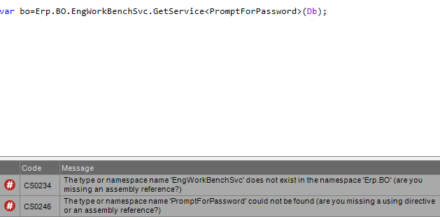

The problem I have currently is that I can’t seem to get the syntax right. Having gone through some of the code snippets within the below post I tried using the following line:
> var bo=Erp.BO.EngWorkBenchSvc.GetService(Db);
Referenced Post:
> [@Adding Business Object Calls into Custom C# Method Directive code](https://www.epiusers.help/t/adding-business-object-calls-into-custom-c-method-directive-code/79396):
> Ladies & Gentlemen, Epicor E70.2.700 Public cloud here and I have a requirement in a Pre-Processing Method Directive to add a record into the UD Codes filewith a specific CodetypeID and CodeID if it doesn’t exist already. getting data from the ttable isn’t a problem using code similar to the following: foreach(var MyUDCodes in (from ThisUDCodes in Db.UDCodes.With(LockHint.UpdLock) where ThisUDCodes.Company == Session.CompanyID && ThisUDCodes.CodeTypeID == "NEXT" …
Doing this I get the following error:
 ![image](https://www.epiusers.help/uploads/default/original/3X/9/e/9e66ddf4509096ebc6e10e56cfe87e1a675e689a.png)
 ![image](https://www.epiusers.help/uploads/default/original/3X/7/0/705c684484b1715c442a4e53f37865d19cb18d2a.png)
I could really use a refresher on the syntax behind this stuff if anyone has a cheat sheet somewhere.

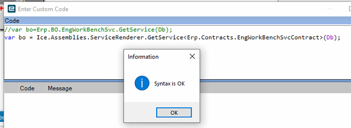

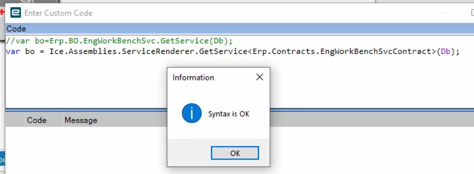

Change to this
```auto
var bo = Ice.Assemblies.ServiceRenderer.GetService<Erp.Contracts.EngWorkBenchSvcContract>(Db);

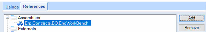

Add a reference
 ![image](https://www.epiusers.help/uploads/default/original/3X/a/a/aaefbb79814479d509a6e12dc322d25ada491898.png)
 ![image](https://www.epiusers.help/uploads/default/original/3X/8/e/8e36c06223c1e37098e51193a5a0cbc67fb0c00a.png)

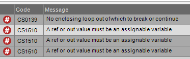

The code works for the original request. I’m now trying to use it with one of the other BO methods.
> this.CallService\<Erp.Contracts.EngWorkBenchSvcContract\>(ewb =\> ewb.GetDatasetForTree(myUser,myPart,myRev,“”,“”,BpmFunc.Now(),false,false, out tsWB));
The BO calls for 8 in variables and 1 out variable. However, when I have the out variable in there I get the following error:
![image](https://www.epiusers.help/uploads/default/original/3X/c/b/cbf0e55fc2c0673a9f2eaa19d4adafcdd9c5e4f5.png)
<div class="post-metadata">
**Author:** ![jtownsend](https://www.epiusers.help/letter_avatar_proxy/v4/letter/j/f14d63/32.png) [@jtownsend](https://www.epiusers.help/u/jtownsend)\
**Post date:** [August 22, 2023, 8:55pm UTC](https://www.epiusers.help/t/call-business-object-within-bpm-using-c-help-needed/106318/7 "2023-08-22T20:55:01Z")
</div>
The method itself returns the dataset. Try this:
```auto
tsWB = this.CallService<Erp.Contracts.EngWorkBenchSvcContract>(ewb =>
	ewb.GetDatasetForTree(myUser, myPart, myRev,
                          “”, “”, BpmFunc.Now(), false, false));

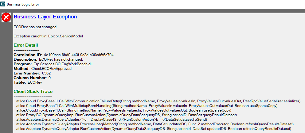

I got all my code built out and the syntax comes out good. However, I am getting an error when running it.
The error seems to be happening on line 214 of the following code:
```auto
//Get user input on part rev from BAQ selection
//Get user op description text from
//Get user change description from form

Error:
 ![image](https://www.epiusers.help/uploads/default/original/3X/a/6/a6aa4dc126430619f17820e4d5dd85b188c02efc.png)
Even though this pops up it still checks out the part into your eco group. I also reapproved the revision and checked it back in but the error still comes up.
Is this something that just needs to be suppressed and if so how?

My first thought is that GetDatasetForTree is grabbing more than you think.
My second thought is that you could probably reduce the number of LINQ calls to the DB. I’m also wary that you’re making direct Db calls instead of copying it to a list and working on that.
It also looks like you’re setting Db fields directly instead of using the tableset and update methods? Yikes.

Currently, the code only checks out a part and unapproves it. The ECORev.RevShortDesc and ECORev.RevDescription are there so that I can see that something is happening table-wise when I do the checkout.
Also, this is all being done in our pilot system not live so no worries about breaking stuff here.
Also I have a partial solution to why the error is happening:
> [@Using CheckECORevApproved and ChangeECORevApproved](https://www.epiusers.help/t/using-checkecorevapproved-and-changeecorevapproved/58574):
> Good morning, I am working on an updatable BAQ that will change Resource Group IDs for Parts. I already used a ton of help from this group to get this working for the open jobs. Now I am working in the Engineering Workbench, trying to update the master parts. See this related post for reference: Back to the task at hand. When I try to use the engineering workbench methods CheckECORevApproved, and ChangeECORevApproved, I get an error: “ECORev has not changed.” Below I have clipped some of the…
The code I’m creating here is based on the works of @NateS. In his post above he mentions that the row mod for tsWB needs to be marked as “U” before the unapproved method can be called.
However when I try to go into tsWB.ECORev.RowMod I get the following error:
 ![image](https://www.epiusers.help/uploads/default/original/3X/5/2/5249735422d7c6c87b496c307034b1d998305a75.png)
Any ideas on how I can swap the RowMod on this sentax-wise?

I have to add:
```auto
using Erp.Tablesets;
to my BPM Usings and References.
