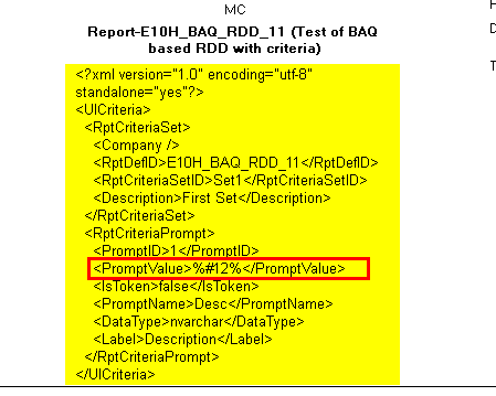

If you want the report to run but with a warning about the qty’s entered, you can get those values from UserCriteria.RptParameter in your report’s datasets. It is an XML string with all the parameters. You’d have to pickout the value from the XML.
In the example below, my BAQ based RDD report has one criteria “Desc”. When I ran it, I entered%#12%, and the RptParameter string was:
But in order for the report to print that value can’t be used to prevent the generation of the report data.
