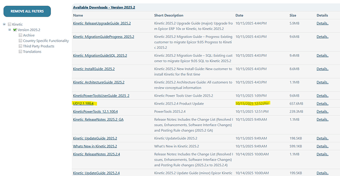

Just checking 2024.2.4 was released last November.
2025.2.4 was released yesterday.
Mistype! Thank you!
