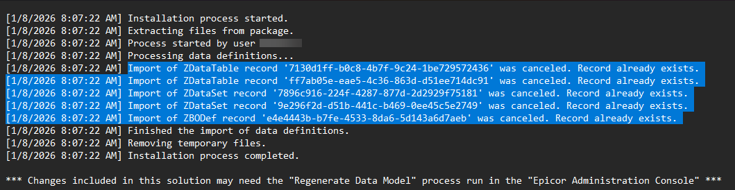

  • Now we want to move the new column to the pseudo-production environment. We created a new solution using the steps but we get an error when installing the solution in the pseudo-production environment that that the above result in a errors when installing the solution that the records already exist (see screen shot)
Does anyone know how to move new columns to a production environment without using the UD Service Designer in production?

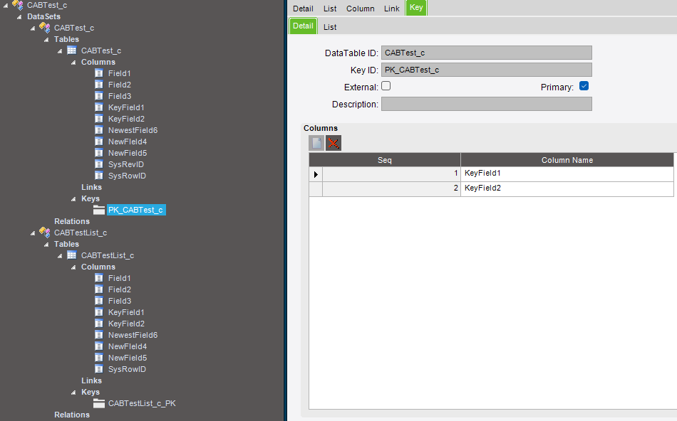

How do you set up your keys? I used the PK_xxx_c key that is generated by default, but changed the fields as shown below. After a number of failed attempts to install solutions, I ended up with a table in my target environment that has the sysrowid as the key and the solution install says ā€œZKeyField: Row has been modified by another user and couldn’t be updated.ā€ I had selected to ā€œDelete the Previous Installā€, which caused the ZBODef and ZDataSet to be deleted, but the delete fails for the ZDataTable with the message ā€œDelete failed for ā€˜CABTest_c’. Deletion of ZDataTable records must be done manually.ā€ We are on prem so I did but it didn’t resolve the problem.
If you have any tips to share I’d appreciate it. These are all test environments - just want to be sure we know what we are doing before we start installing in production.
Thanks for taking time to respond Gabe. I did try with the ā€œOverwrite Filesā€ and ā€œDelete Previous Installā€. During the delete phase, I got the message that ā€œDelete failed for ā€˜CABTest_c’. Deletion of ZDataTable records must be done manually.ā€ And when I did that, Solution workbench gave me a row has been modified by another user on the ZKeyField, it had generated the default primary key and didn’t like the fact that I had different fields in the key. Went down a lot of rabbit holes after that including deleting records in the ZDataTable, ZDataSet and ZBODef and the reinstalling the solution. Sadly I lost track of all the things I tried. At this point my table in the target environment has the wrong keys (It chose SysRevID oddly) and no List table. Datamodels gen, Conversion 210 errors on that table.
These are all Test environments so I’m only sad that I can’t get it to work -nothing that matters is broken.
You can see a screen shot of my service definition from the source environment in my response to Jonathan. If you have any tips, I would welcome them.

Without the delete, I just get this:
[1/19/2026 9:05:18 AM] Installation process started.
[1/19/2026 9:05:18 AM] Extracting files from package.
[1/19/2026 9:05:18 AM] Process started by user cbrown.
[1/19/2026 9:05:18 AM] Processing data definitions…
[1/19/2026 9:05:18 AM] Import of ZDataTable record ā€˜5cb3cac1-cdc6-4e5d-b935-70768daad7ac’ was canceled. Record already exists.
[1/19/2026 9:05:18 AM] Import of ZDataTable record ā€˜66077020-8f52-4e7c-9e93-51265be86a10’ was canceled. Record already exists.
[1/19/2026 9:05:19 AM] Import of ZDataSet record ā€˜609e696d-3188-4b01-ab29-619f177a302c’ was canceled. Record already exists.
[1/19/2026 9:05:19 AM] Import of ZDataSet record ā€˜b979cf73-a123-426f-ad84-0574a5e13647’ was canceled. Record already exists.
[1/19/2026 9:05:19 AM] Import of ZBODef record ā€˜67b3c1ef-a8db-4de7-bb9e-ee273a4ee245’ was canceled. Record already exists.
[1/19/2026 9:05:19 AM] Finished the import of data definitions.
[1/19/2026 9:05:19 AM] Removing temporary files.
[1/19/2026 9:05:19 AM] Installation process completed.
