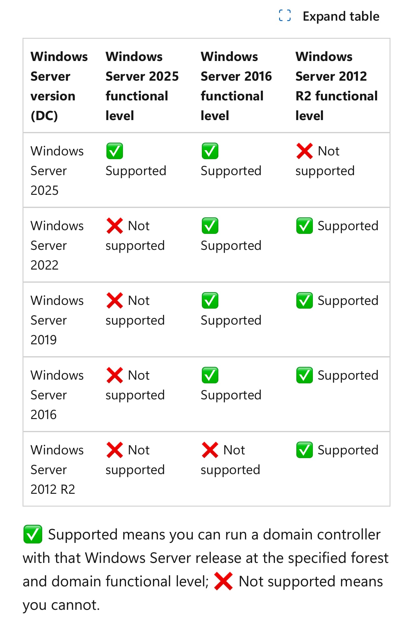

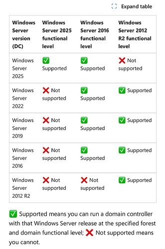

Microsoft says don’t do it… guess it’s up to you how much risk you want to take. There are major authentication changes from 2008 to 2016. The ciphers change and old machines can lose the ability to authenticate. If you’re ok with that risk then do it.
I stand corrected, my memory of 2008R2 with 2016 was from long ago when 2008R2 was still in Extended Support and they had not significantly changed things in 2016. I do see after looking it up that they really started to lock things down between 2020-2022 and that those would likely break the older’s ability to function fully/properly.
