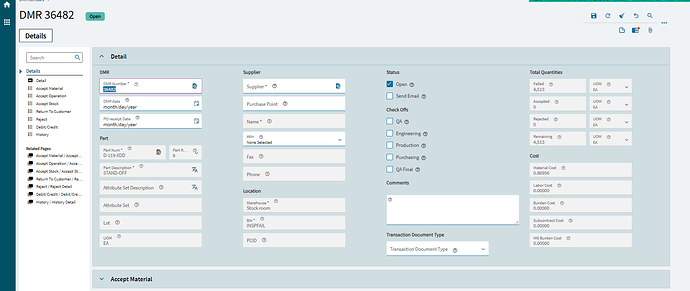

Can I generate a ssrs report on DMR screen
Hi All,
Can I generate a SSRS report on the DMR screen?
There is no report option on the screen.

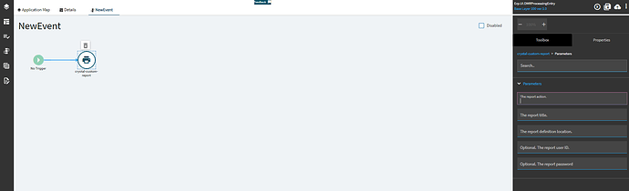

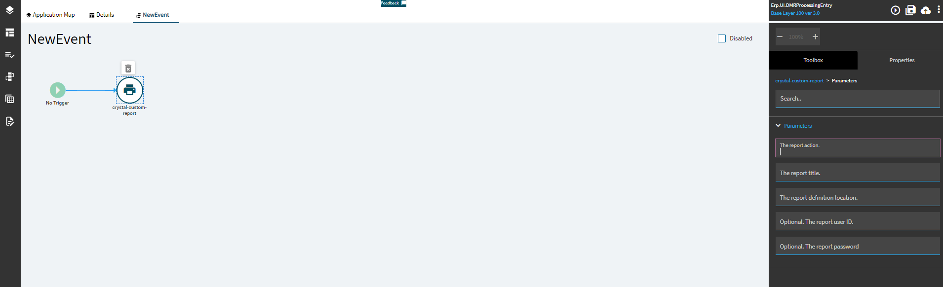

I found this, crystal custom report in application studio, but there’s not any mention of this in 2024.1 App studio guide.
Maybe you can use this custom code and write a function that uses that code.
And instead of running the job traveler run a custom SSRS report.
there’s a widget in app studio for function. You could pass the function the DMR you are on.

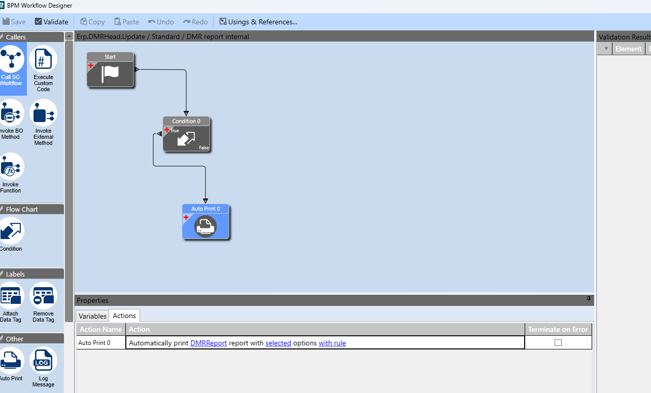

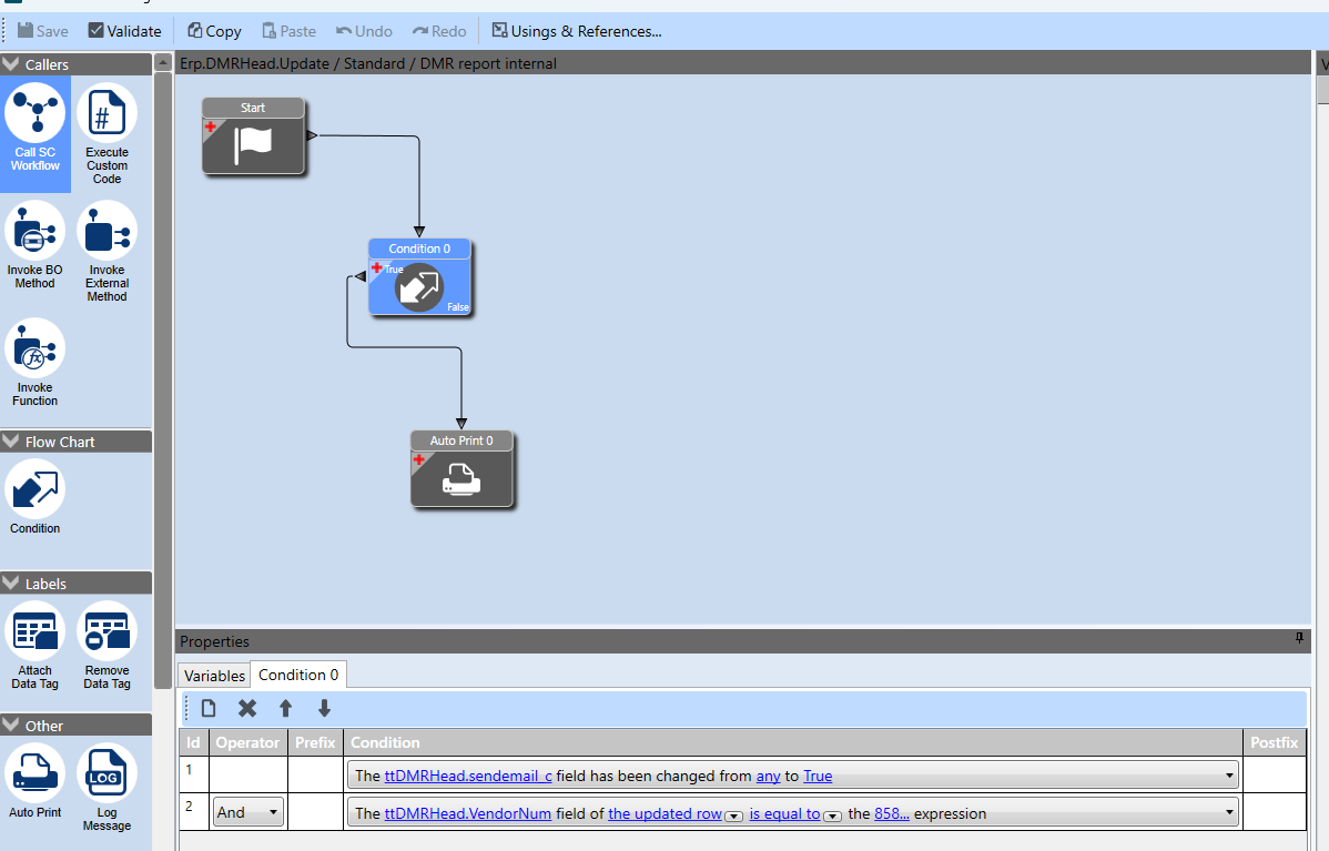

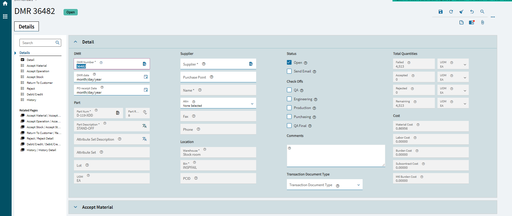

I used data directive driven by a checkbox, when its value is true then:

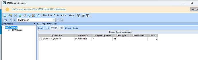

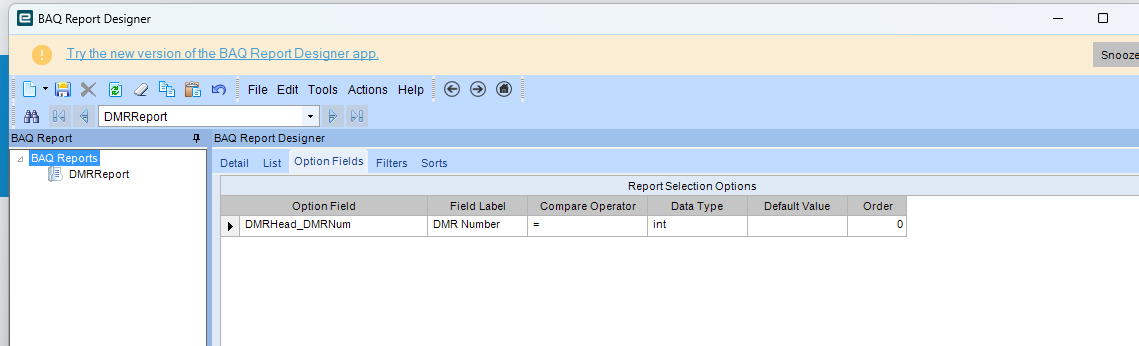

And the DMR report is a BAQ report:
Hope this helps.
Nice job! Yeah it’ll help others, nice use of standard BPM widgets and out of the box functionality.
