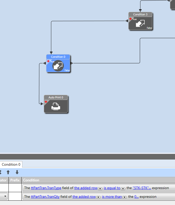

we are facing an issue where Bartender detects a record insertion in parttran and generates a bt file.
When we use issue material where one by one transactions are done, bt file is generated correctly using data directive.
when we use mass issue, the number of labels are always n-1 or n-2.
so i was thinking insert a delay just before auto print and see if that is going to detect all the transactions.

But the bt file is generated using data directive, even if take the bartender out.
Shouldn’t the data directive detect and generate the file, Bartender is just reading a file generated by Epicor.
