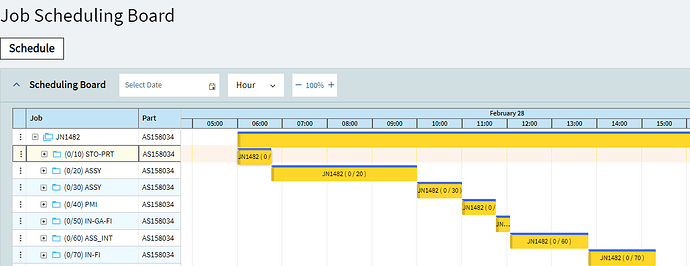

Currently, all of our operations are scheduled ‘Finish-to-Start’, like below:
Is there a way I could schedule operation 50 to start after operation 10 is complete? (I.e. leaving the rest of the operation order intact).
The effect that I’m trying to achieve is that operations 20>30>40 can be done simultaneously with operation 50>60>70. The last operation (Op 80), would be started after all other operations are complete.

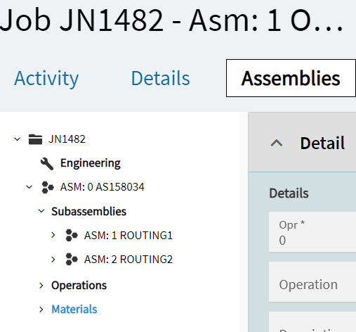

Edit: I might have been thinking about ‘sub-assemblies’ too literally, as components on the BOM.
Presumably, I could do something like this, with ‘ROUTING1’ and ‘ROUTING2’ as sub-assemblies, containing the respective operations.
Would I then also need to move the materials under the sub-assemblies, or could the materials still be issued to the top-level?

You would need to move the materials to the sub-assemblies that need them.
You can still use the CAD BOM to import, you just need to import them in a different manner. First, you would import Routing1 with it’s BOM. Then you would import ROuting2 with it’s BOM. Finally, you would import the 0 level BOM that is just the part number for ROuting1 and Routing2.
