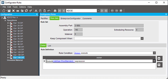

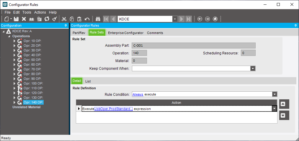

I am editing a Configurator made by a consultant a couple of years ago.
Is it possible to add/edit operations in the Super BOM?
I am actually not even sure how the Super BOM was initially created, was it in the Engineering Workbench or in the Configurator Rules? At least it cannot be checked out to the Engineering Workbench anymore.
I have also a more specific question: How to set Final Operation and Auto Receive into Inventory automatically for the last operation of the configured part (In this configurator, the last operation is always the same).
These fields seem to not exist in any table at all.
