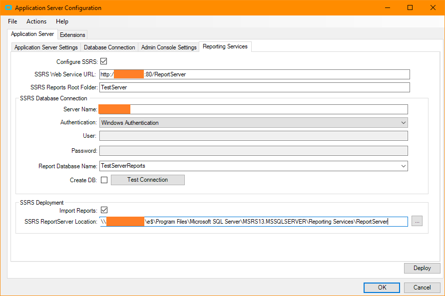

I deployed Test without SSRS because I was scared to. We only have one report server.
What happens if I reference it in the Application Server Configuration, in SSRS ReportServer Location, as shown below?
What I mean, is what happens to Production reporting? Will some reports not work?
If you select the same DB for the Report Database Name, both environments will share the same reports and storage area.
If you also have the “Import Reports” checked, it will write over any existing reports (other than what is in the \CustomReports folder).
In our 10.1.400 (production environment) our Prod and Test Apps both point to the same database.
I’d be concerned about a version change (from .300 to .500) having incompatible reports. If you do import the reports in your 10.2.500 App, they may break some of the the 10.2.300 reports. And if you don’t import them, some of the RDLs made for 10.2.300 might nor work with 10.2.500.
Technically speaking, you’re damned if you do, and damned if you don’t.
OK, so you are saying that Import Reports would very likely break Production. Don’t do that.
But Deploying SSRS without Import Reports might work OK? I mean, Production will be OK but Test might have some issues? If so, that’s worth a shot.
Otherwise, what? Make another report server? On the same SQL server?

Making another DB for reports for your test environment is as simple as Entering a new name and checking:
The down side is that now you’ll need to copy all your custom reports to this new DB. Not too bad if you only added to the CustomReports folder, and didn’t change or add anything outside that. I can’t say that I was that lucky.

OK so using a report database different than production is sufficient. Using the same report server is totally normal, right?
Then out of curiosity, SSRS ReportServer Location is what? The destination or where it pulls RDLs from? Or am I missing the point completely?
I would say this is okay ONLY when the two environements are the same version (not including the “patch” - the last number after the 3 digit segment)
If production is 10.2.500 and Test is 10.2.500 then yes, its okay.
BUt know that a change to a report in the test environment also (and immediately) affects the production. This is a double edged sword. If done properly, you never need to move your updated RDLs between environments
