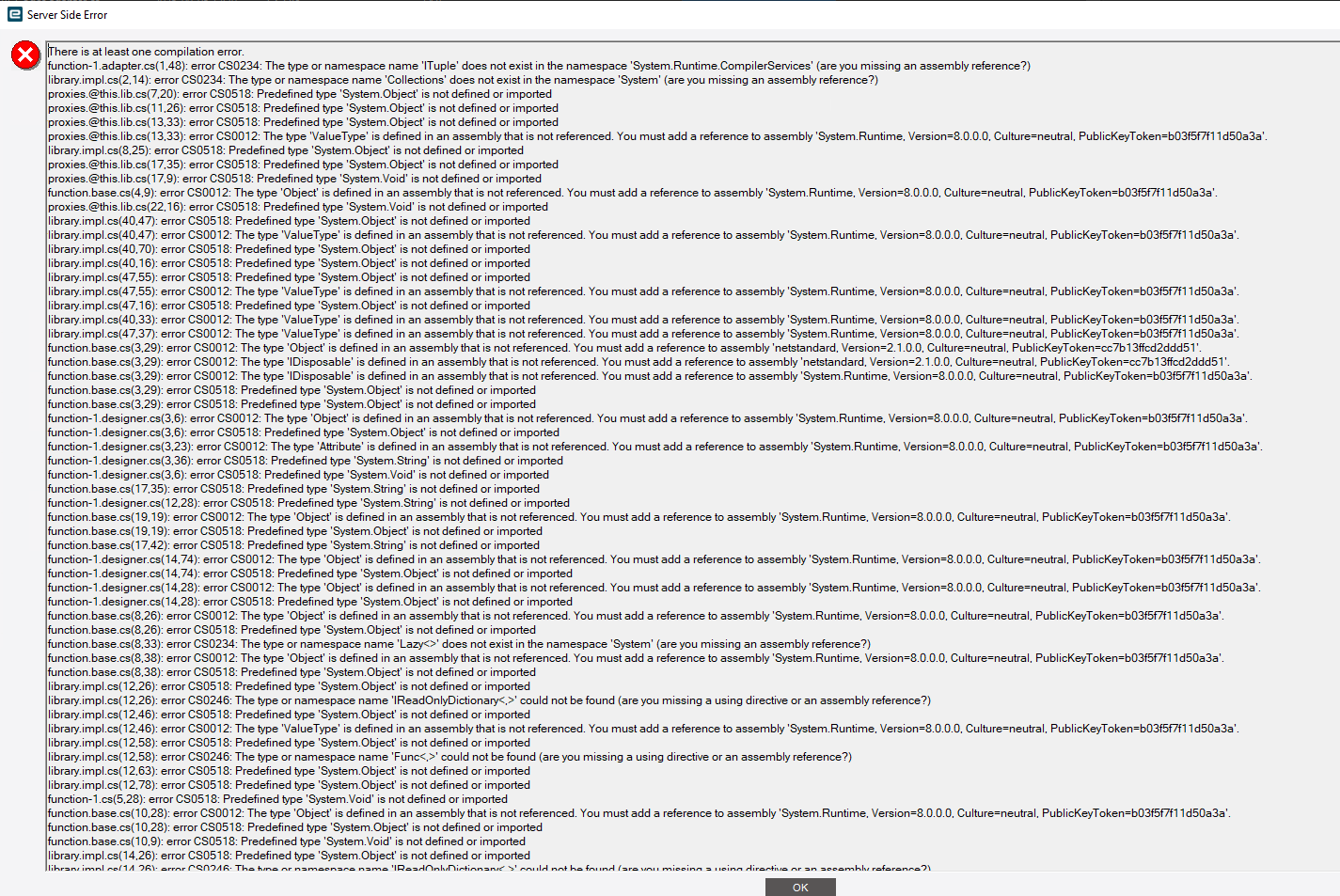

So, we’ll soon be upgrading our live system to 2024.2.12. We set up a new environment, and at some point, we noticed that our functions were not working as expected. Perhaps some of you have encountered the same issue before.
When we are creating new library, creating function and click save this error shows up.
Using “dump sources” option generates library files as normally but also the errors.txt file with the same contents as shown on the screenshot.

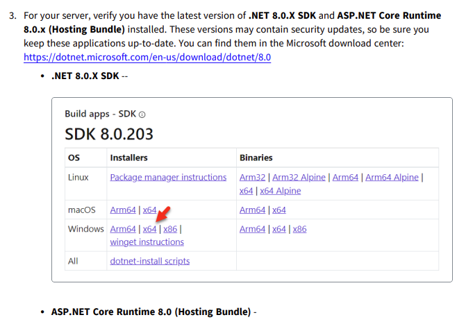

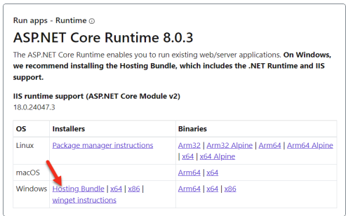

Whenever you see a runtime version error is probably because either the Client or the Server is missing the target version for the Kinetic version requirement.
On the server you need the 2 below. On the client you only need the SDK.
We have done that before installing kinetic

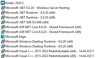

It seems that was too much…
Now it is like this and everything is working
Good that you got it solved. Either missing or wrongly installed. In any case, the error was/is telling what the problem was/is.
