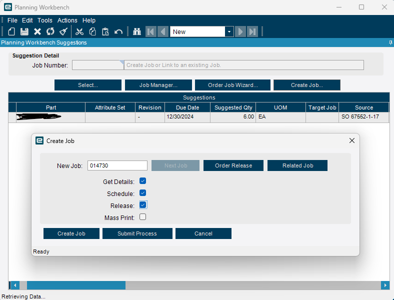

Can Planning Workbench be forced to use the Part MOM even if the source is an SO?
We will sometimes make slight changes to the Part method after winning a Quote. The production planner will then use Planning Workbench to Create Job and Get Details, but he finds that the new job has pulled in the old Mfg Details from the Quote.
The request that hit my desk was to force PWB to use the Part MOM, but what is best practice here according to the gurus?

There’s not a popup when you check Get Details from Planning Workbench > Created Job though. As best as I can tell, it just automatically defaults to the “Quote to Job” version of the Get Details logic when the Source on the Suggestion is a Sales Order with a linked Quote.

It’s looking at these fields. (which you probably already know). But since they don’t have a UI for selecting which BOM to use, it’s going through a decision tree and deciding based on the links it can find.
What I would do, if I didn’t want it to ever use quote boms, is to do a trace, and find the first method that has the linked quote fields in the parameters and clear them on pre-processing. I believe then it just won’t find the link and move onto the master method and use that one.
I haven’t done it, so obviously test it, but that’s what I would do.
I may be bad at tracing. I don’t see the quote/line readily available as a parameter. The only two methods I see firing right before the job gets created are:
<businessObject>Erp.Proxy.BO.JobEntryImpl</businessObject>
  <methodName>CheckTotProdQty</methodName>
  <methodName>CreateJobPWB</methodName>
No quote as a parameter. I could access PartSug via the sysrowid, but I don’t think stripping the Source would help? I could set GetDetails to false via BPM or just hide the control via customization and force them to get details manually on the Job…
Damn… Looks like you ran into one of the black box processes. I hate those.
The only other thing I can think of is stripping the quote link from the orders. But that has other implications so that’s messy.
