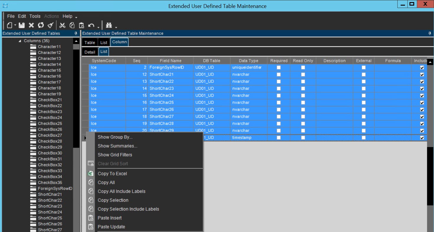

You can copy them from the Dev, using list view, into Excel and then paste them into Test in the list view.
Can also add them to a solution and transfer them that way, I believe.
