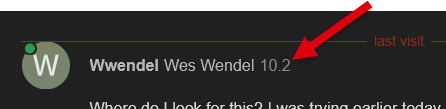

Where do I look for this? I was trying earlier today and could find nothing.
What version are you on? 10.2 it’s not there yet.

It might be time to update your profile.
