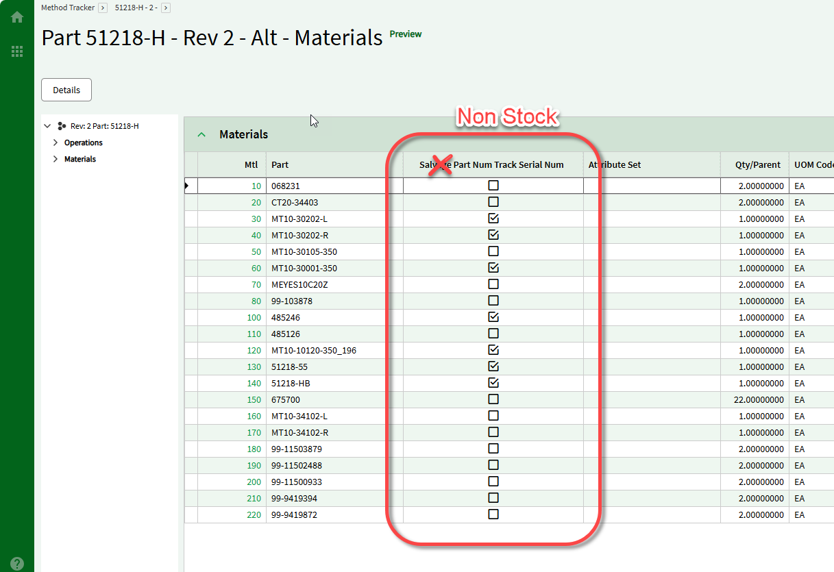

In the Method Tracker, material list, we would like to show the Part.NonStock field of the material part.

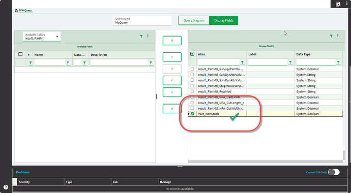

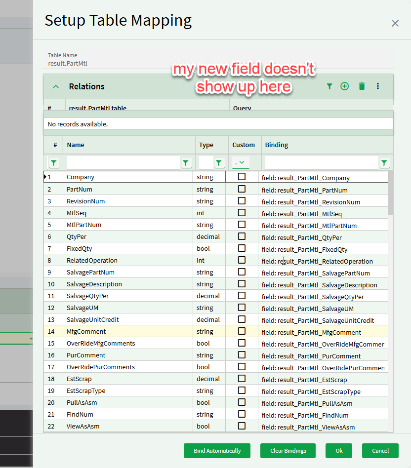

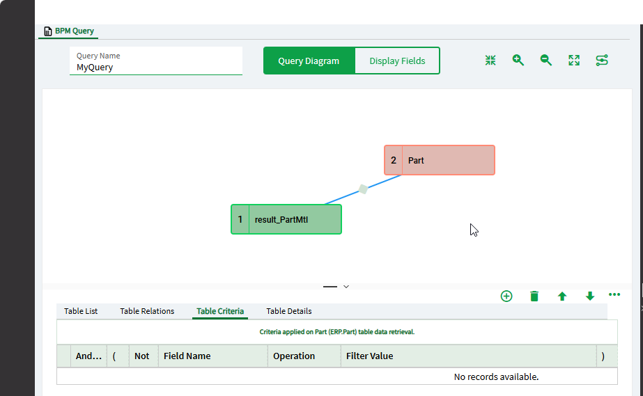

So I tried using an ‘Update Table’ widget, created a query joining result.PartMtl and Part on Company and PartNum and then tried to configure the mapping. But it doesn’t seem to see the new field. I did add the field to the grid in app studio.
Any suggestions?
No.
And the code way is just a bonus. It was not designed that way, and would not have worked with classic.
Hmm.. ok thanks

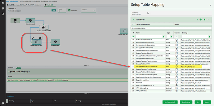

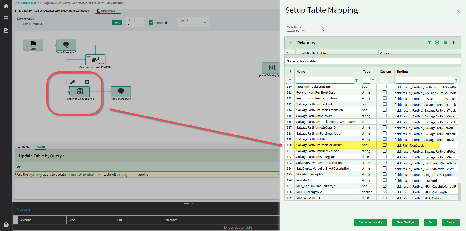

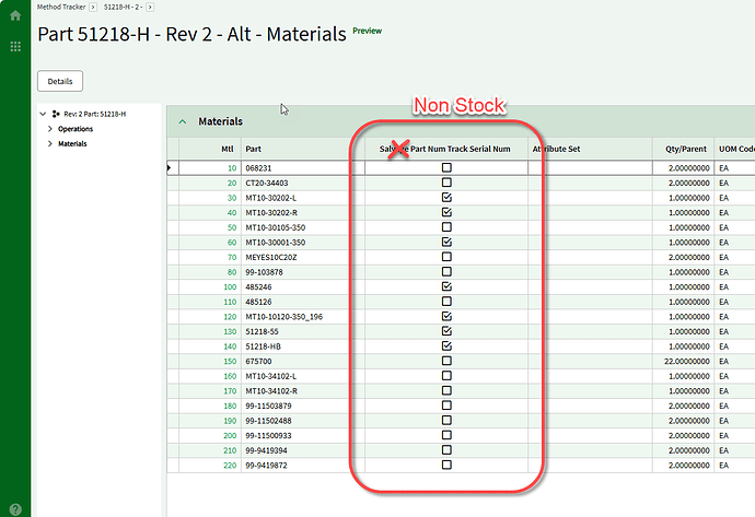

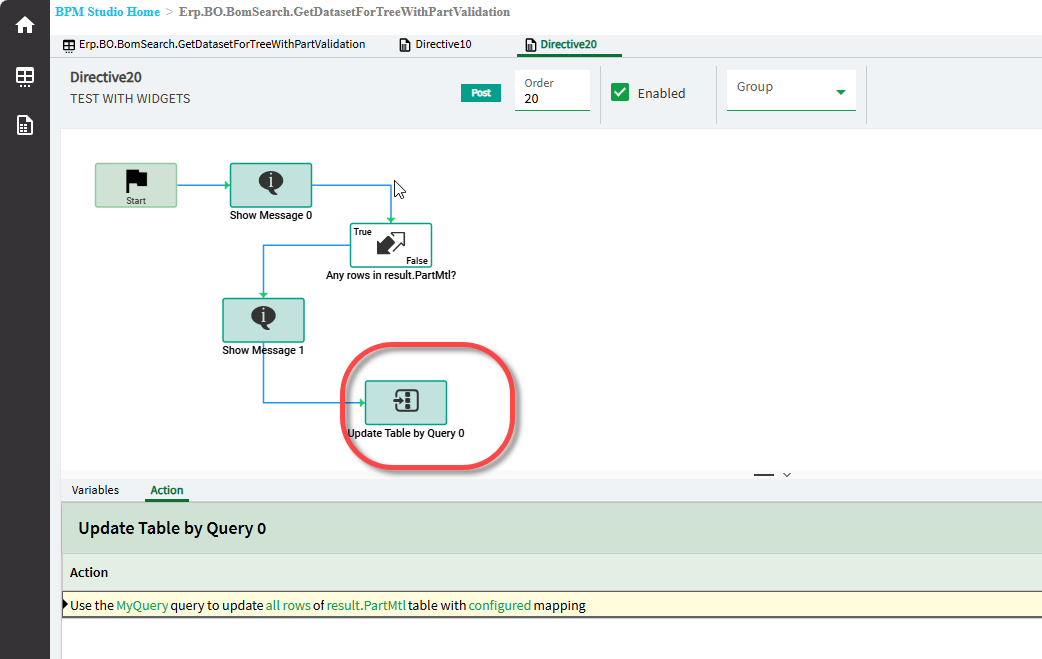

Ok I got it to work, sort of. I used an ‘Update Table by Query’ widget and configured the mapping so that the NonStock value from the designed query maps to the ‘SalvagePartNumTrackSerialNum’ field - which we don’t use. If I then show this field in the grid, it has the correct NonStock values and works. So it’s not a perfect solution by any means, I just wanted to see if it was possible. It seems you can’t add a field/column to the result.PartMtl table without code. I’m not against using code, I just wanted to see if it was possible without, possibly making it easier for someone to maintain in the future.
