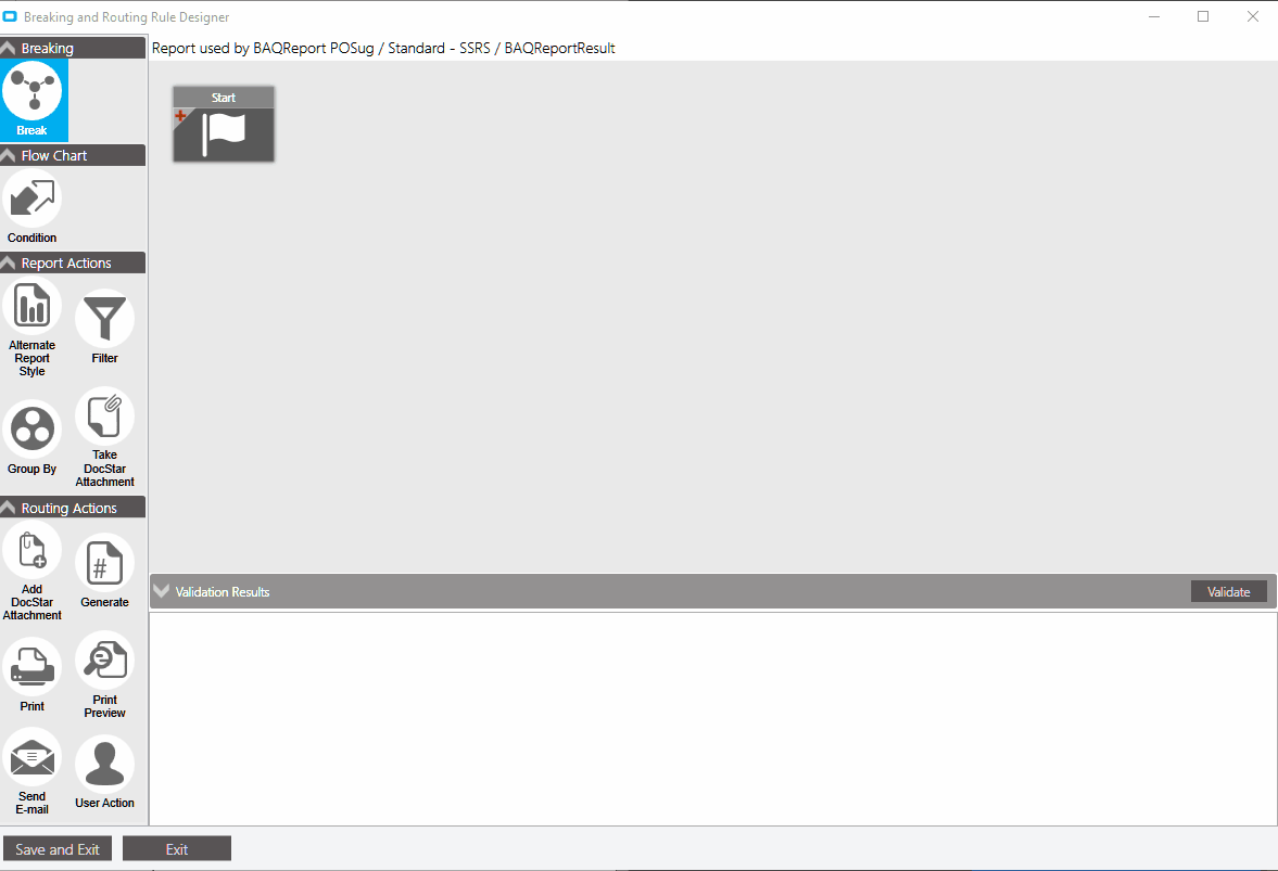

10.2.400.2, nodes cannot be connected in the Breaking and Routing Rule Designer. I can drag the arrow, but it doesn’t snap and disappears. Am I missing something or is this just broken in this version?
rule requires a break, can you add one and test again?
Added a break and still cannot connect. No nodes can be connected to any other nodes.

I think you have to configure the Break widget after adding it, and before making any connections.
And the flow must be Start -> Break -> [ next widget in you flow ]
Still no luck even with only a break
You have to connect it to a triangle. Not just the middle of the widget.
Click! That was dumb of me…
I found how precise you have to be with getting it to connect frustrating. What you did works in the bpm designer, but not in the apr designer.
