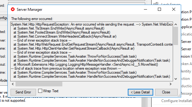

I tried to upgrade the system to 2024.2 and installed Epicor ERP_Service Packs_RL11.3.200.0 and Epicor ERP_11.3.200_UD11.3.200.4 and then opened Admin Console to upgrade the DB , after that tried to connect the Application Server but i have this error
What’s on event viewer? Also what’s the full error?

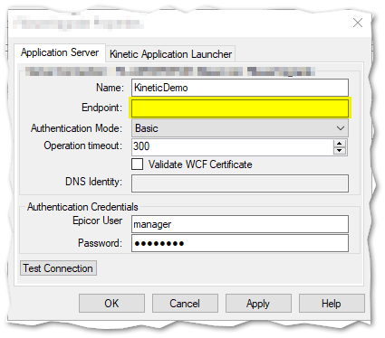

I just went through this, and it may be what’s happening with you. After installing a new Demo Database, the endpoint on the properties of the App Server was incorrect:
If you right click on the Application Server in the EAC and choose “Properties”, check this setting and see if it is correct.
