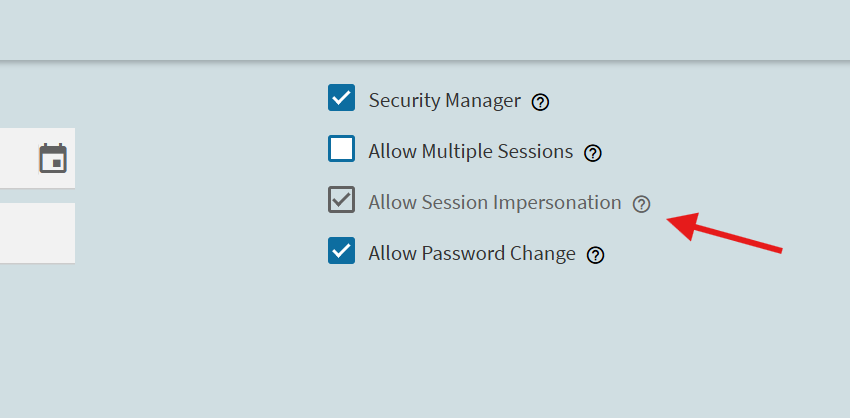

Edit: Also, I can’t seem to change the Allow Session Impersonation field on any users, whether from Manager or my own (security manager) user:
Its a new restriction. You can’t control the allow session impersonation setting anymore. Instead you have to put in a support case to turn that on or off.

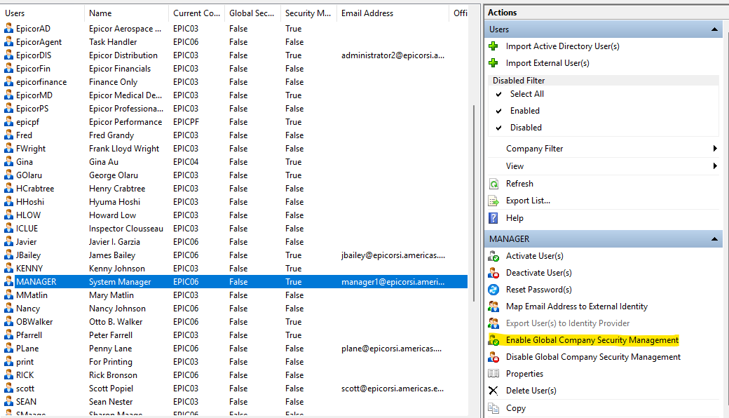

These BPMs run in Company 000000 (Master Cloud Tenant) and are not accessible to you/us in typical ways. They are typically data directives and check for things like Global Security Manager (which is not a setting exposed to us in the UI, so we cannot ourselves make any user a GSM)

GSMs are set in the Epicor Admin Console, which cloud users do not have access.
