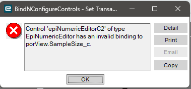

We have a pilot version of kinetic and I have a customization that is not working because I have an epibinding to fields that are not available. I have regenerated the data model twice and ran any conversions that were pending. Not sure where to turn to now. This works fine in 10.2.700 but not 2024.2.Examples below.

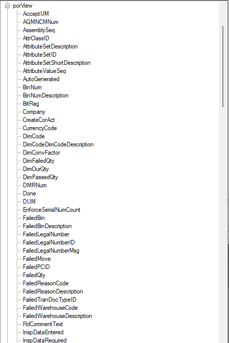

This is Kinetic and a image of porview: my ud fields are not there.

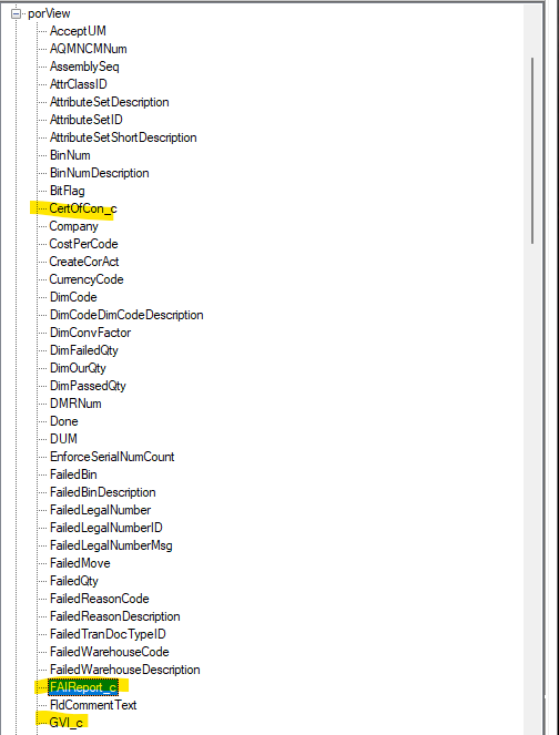

Here is our current Production instance and the ud fields are in the list.
these are ud fields on rcvdtl
