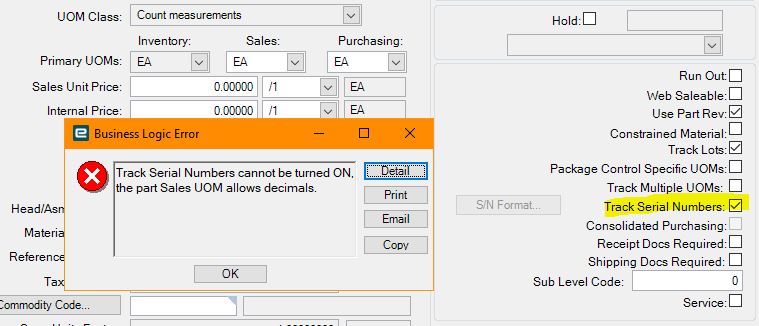

I am testing some serial tracking, and for an existing part we have the UOM EA that allows decimals. I added a new UOM called Single to the Count UOM class. Single does not allow decimals. I can set the part sales and purchasing UOM to Single, but the default inventory UOM is still stuck at EA. How do I convert that? I do not currently have any parts in stock in any warehouse.

After reading the error message again…
It says the Sales UOM is the problem, not the Inventory UOM. You CAN change the Sales UOM. Do you have a sandbox environment you can play in? You might get away with just adding the non-decimal EA to this UOM Class, the conversion rate would be 1:1, and then re-assigning the Sales UOM on the serial tracked parts.
That was my first try. The error is just one of three. After you fix sales, then the problem is purchasing, then the problem is inventory.
Ah ok. That was how I remembered it being, but saw the message and thought you might have a chance!
