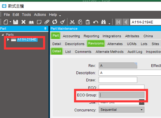

I would like upload the BOM thru DMT in epicor
step 1 .upload engineering workbench group
Company GroupID Description
FFH A11H-1928D A11H-1928D
FFH A11H-2194E A11H-2194E
step 2. upload part revision
Company PartNum RevisionNum RevShortDesc EffectiveDate Plant
FFH A11H-1928D A A 2017/10/02 MfgSys
FFH A11H-2194E A A 2017/10/02 MfgSys
No error during uploading
result :
can upload the revision no. except the ECO group in part master
ECO Group is populated only when the Part is checked out.
okay, thanks!!
