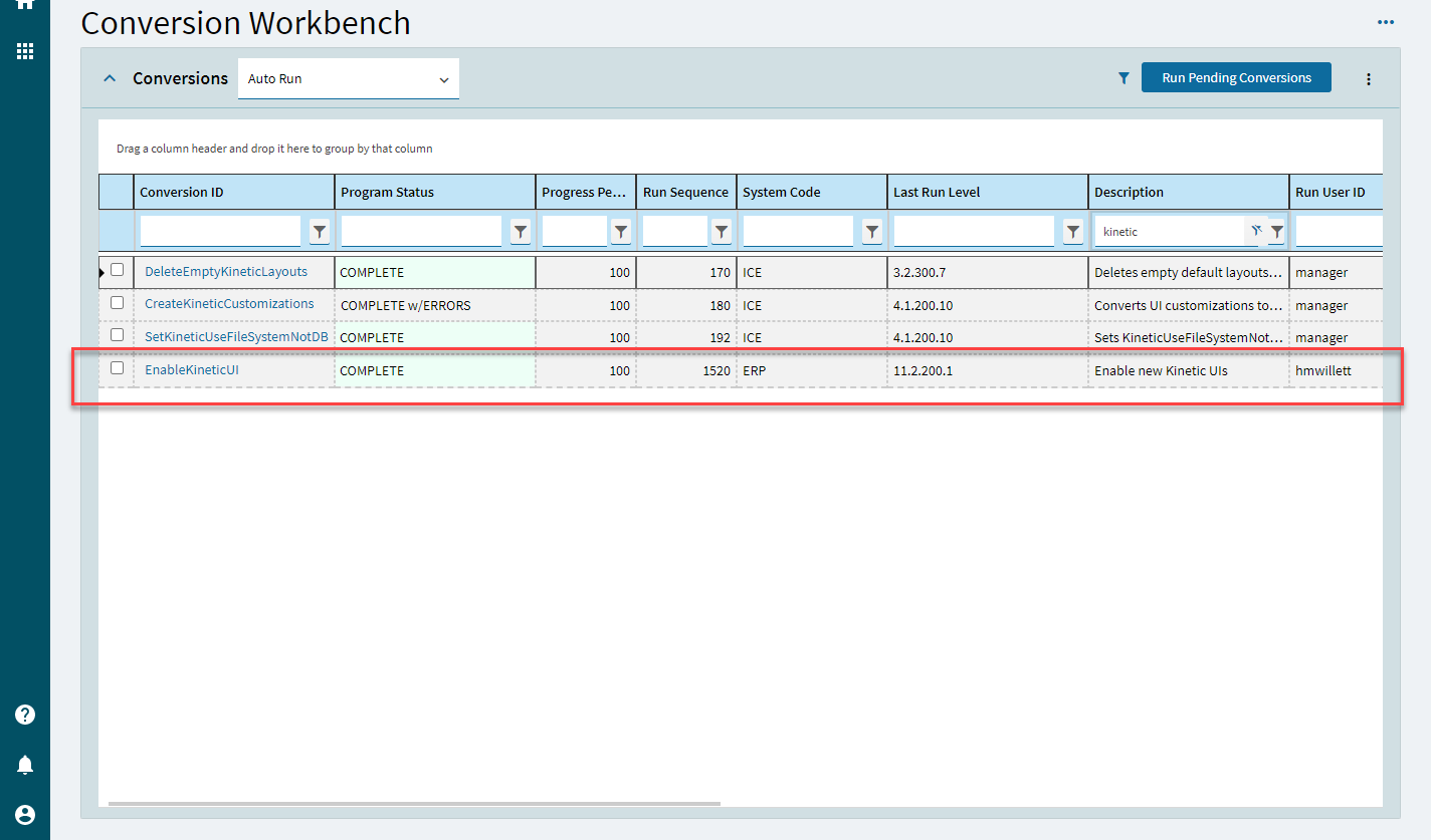

You could try running this conversion routine?

I will check to see if it has been run. (Cloud Services may have already run it) We have been working with support on this issue and we have had a hard time figuring it out.
