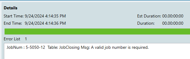

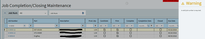

Now trying to close the job in Job Closing… whether I type the JobNum in manually or click on it in the grid, we get an error that “A valid job number is required”.
It shows up on the landing page grid… its obviously THERE. Its even flagged as a candidate for closing. But the JobNum won’t be accepted for some reason.
Thoughts? Never seen this behavior before.

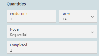

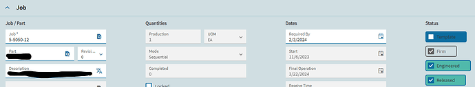

Oh yes… if you’re referring to my first image… we generally ship from the job and not worry about “final op” etc. I DID go back and throw in a time entry against the final op… Job Entry now shows complete:
… but didn’t make a difference. Still can’t open this job in Job Closing.

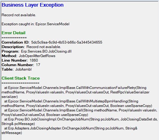

I jumped into the Client and classic form (errors there provide more detail)… here’s what it is saying:
The NEXT job: 5-5050-13 opens right up. But 5-5050-12 is stuck.
Perhaps corrupt in some way. I can enter a case, perhaps need a datafix. Just wasn’t sure if anyone has come across this before.
The error says table:JobAsmbl. If you open the job in job tracker, can you see an assembly on it?

I’d try closing via DMT, but if that doesn’t work yeah it looks like you might need a datafix.

Ok one last thing to check. The method in your error is JobOperAfterGetRows. Did a quick search and found someone who was running into an issue releasing a job. There was a JobOper with no parent assembly: Unable to release a job. Receiving error "Record not available" - #3 by dgross
Is it marked as Make Direct?
