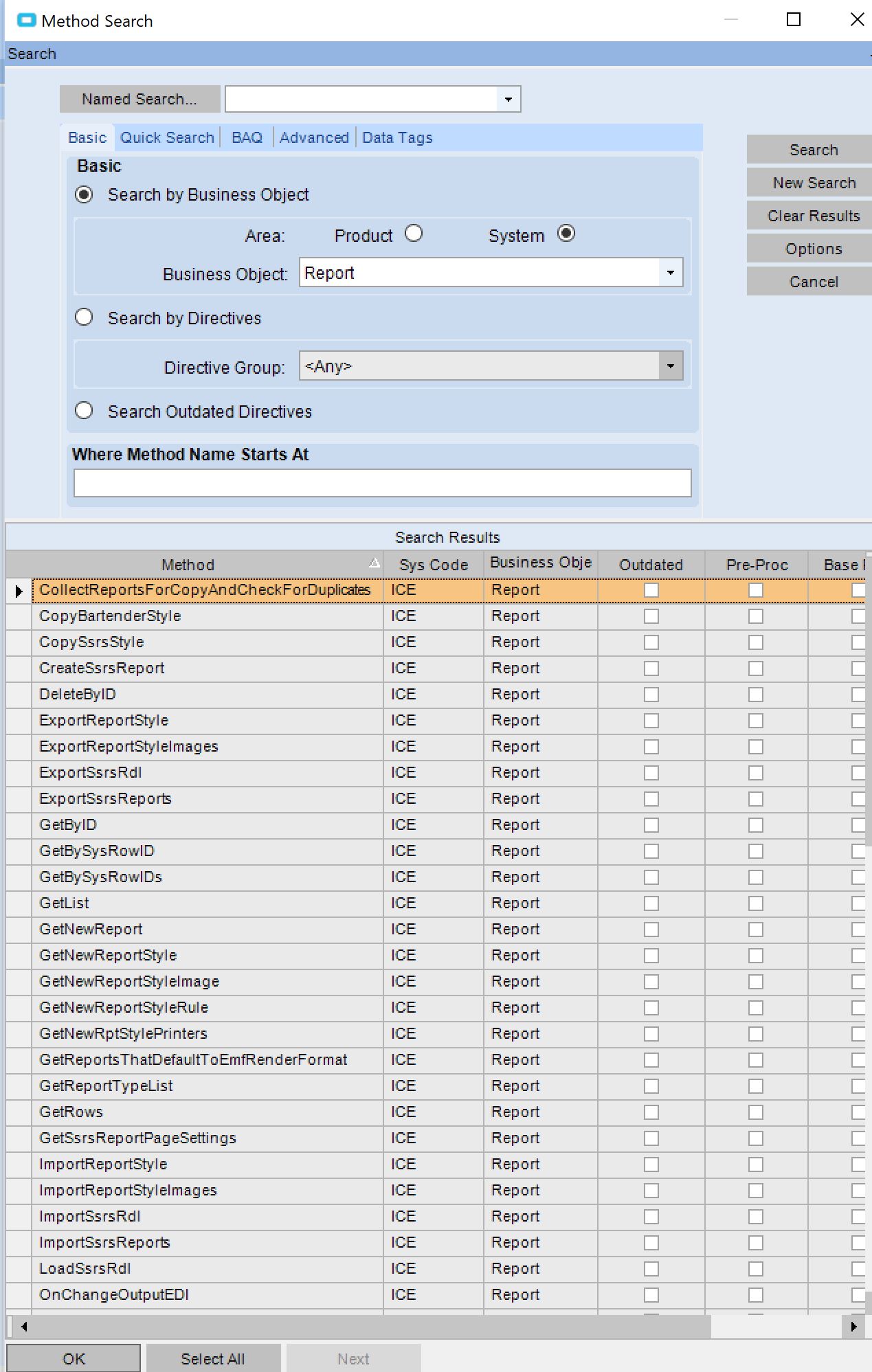

When I go to Method Directives and search for this method I have to check “System” to see the “Report” business object. But when I then search for the method directive there is nothing named “GetReportStyleRules” although there are some that are similar such as “GetNewReportStyleRule”.

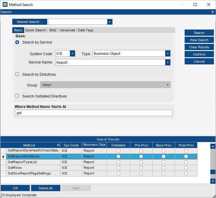

Hi Michael,
Sorry I don’t have a solution to offer but just wanted to show that in 2022.2.8 that Method does appear in the list. The Method search dialog has changed a bit since 10.2.

Not all methods are accessible from BPMs. The Report BO being one of them.
That similar sounding one is probably the in that fires in Report Style Maintenance
