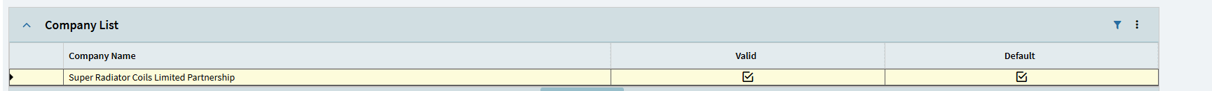

I came across the same issue after importing a solution for a RDD report. I was able to generate the form after selecting valid and default under company list. The generate form button worked afterwards.
