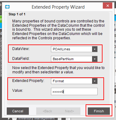

## Post #3 by @rbucek
The most consistent results I've had is to use the wizard to set the extended property to >>>>>9 or >>9 depending on your expended values etc. You can avoid having to do anything in form load event if you don't need it.

## Post #5 by @rbucek
No data model regeneration needed. I'm not near my workstation at the moment, I can send some screen shots later.

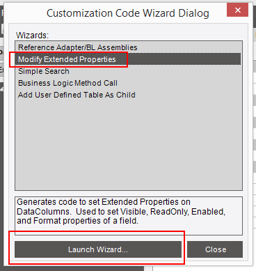

## Post #6 by @josecgomez
@JeffSanders
I think @rbucek wants you to use the Wizard in the Customization like this
## Post #7 by @rbucek
Yes, thanks @josecgomez.trigemco
