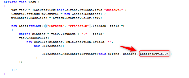

Thanks for your help @Joseph_Martin ,
Still not working. I’ve copied and pasted your code with no positive result. Although, the SettingStyle does work.
 ![image](https://www.epiusers.help/uploads/default/original/3X/f/8/f89486c29cd26bb8591fb482cb06c803c507b9ab.png)

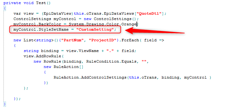

Got it. After decompiling the EpiClientLib.dll and making some tests, I finally made it work. First time I’ve encountered such problem. It always worked nicely before. Anyway, I got what I want.
 ![image](https://www.epiusers.help/uploads/default/original/3X/7/1/71af6e12600d0191a8d9df48567591a0126e5aff.png)
EDIT. When the StyleSetName was left empty, it did not have the behavior expected.
