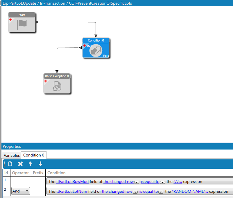

I have an In-Transaction Data Directive on the PartLot table. All it does is throw an exception when a row is added to PartLot with a LotNum with a particular string. The string doesn’t really matter. What’s happening though is that if I go to Lot Entry and try to make a lot with this string, the BPM exception triggers and successfully prevents lot creation.
However if the lot is created in MES on the Report Quantity screen, the BPM Exception message successfully pops up but the lot creation is actually not prevented. I’d assume an in-transaction data directive should still cover it but something weird is going on? Anyone have any insight into why the BPM exception isn’t preventing the creation? Thanks.
This also exhibits the same behavior, and doesn’t work in Report Quantity, but works everywhere else:
foreach(var row in ttPartLot.Where(n => n.RowMod == "A")){
    throw new Ice.BLException("Stopped");

Thanks for the response Bruce. I’ll definitely keep the service security in mind for other projects. However the reason for the BPM on PartLot actually has nothing to do with security. It’s part of a larger integration where essentially an automated process stores a lot number on a Job UD field and that is pulled through as the lot number when Report Quantity is done in MES. If certain criteria are met then the Lot Number ends up something like “Lot Invalid”. The BPM is inplace so that if the Lot Number = “Lot Invalid” then it is supposed to prevent the creation of the lot regardless of who makes it.
However the issue is that this BPM while triggering (so I know the criteria is good), the exception is not actually preventing the lot from being created if it is created through Report Quantity. This behavior is weird and something I have not seen before; an exception trigger but actually not stopping the behavior.
