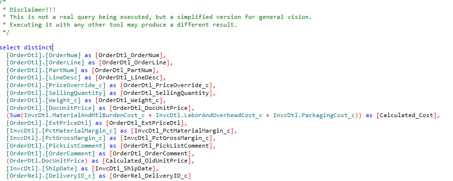

Here’s the select clause of the BAQ I’m talking about. Notice the last tow lines:
[InvcDtl].[ShipDate]… and
[OrderRel].[DeliveryID_c]

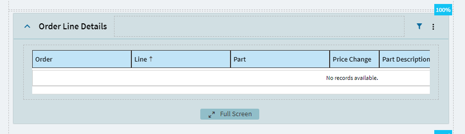

My Kinetic page has a panel-card-grid in the middle of the screen that looks like this:
Next to the Ship Date column which was connected to [InvcDtl_ShipDate] I had another column that had the title “InvcDtl.ShipDate” which wasn’t in the grid’s list of column.
Through some experimentation, I found that placing the name “InvcDtl.ShipDate” in the Hide Columns removing the unwanted coulmn. That was about an hour ago.
I just saw your request and thought I should try to show you the bad column, so I emptied the Hide Columns and Previewed the screen again. I don’t understand what happend, but the unwanted column (what I was calling an orphaned column) do longer appears.
