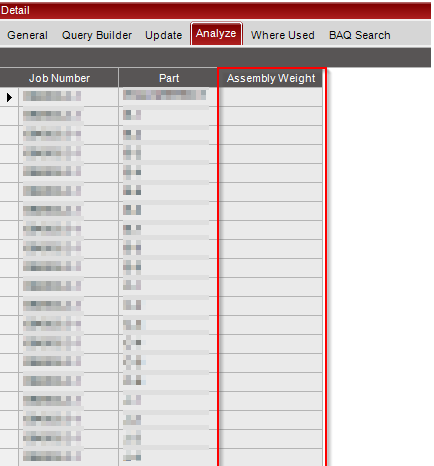

I have a strange situation where if I write a BAQ on erp.JobAsmbl, it will not retrieve the weight field even though the weights are populated in the table. I can see the same behavior in job tracker where the weights are not displayed in the grid even though they exist in the database.
I reported this to Epicor who insist its not a bug because assembly weight is defaulted from the part master, and if its a part on the fly and doesn’t have a weight in the part master, then by definition the assembly weight doesn’t exist.
I disagree - even if that is how the grid in job tracker behaves (which is not what is documented - the field help says its bound to that field not that it is a calculated value), I should still be able to get that value from the database in my BAQ but my BAQ returns nothing.
The only workaround I can think of is to copy the weights from the Job Assembly weight field to a custom UD field, and then write my BAQ to retrieve it from there instead. Seems kind of absurd. Any other suggestions?
We would need a little bit more info such as maybe a SQL Screenshot showing us the database side of things or the BAQ Query.

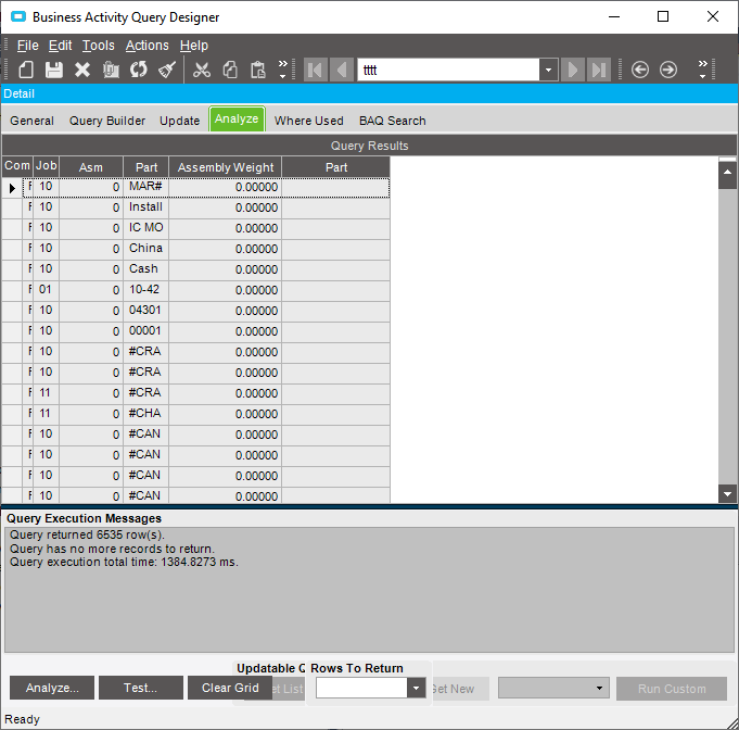

Thats interesting you shouldn’t see blanks, you should atleast see 0’s.
If I do <> 0
So in either case, both have a “value”
I think I should see the values that are in the table!!!
I’m guessing you get zeros because you have system defined parts?
Since there is no part master record for my POTF its returning null instead of zero.
I get 0 for PoF and Part Master.

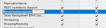

In the zDataField table, it says you need to have a required module to see the weight.
The module is 00000003-886E-4FCC-8702-FC199E84F2BE, but I don’t know what that is…
AMM?
RohsWeeeManagement "00000003-886E-4FCC-8702-FC199E84F2BE"
Interesting! We don’t have RohsWeeeManagement, thank you for looking that up!
OK… so that is what? Restricted substances or something?
What is RoHS? RoHS means “Restriction of Certain Hazardous Substances

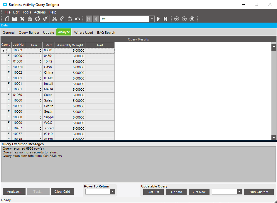

For example here is me getting my weight and adding +5 to all of them:
Basically you give your read-only Updatable BAQ - BPM Powers. :slight_smile:
