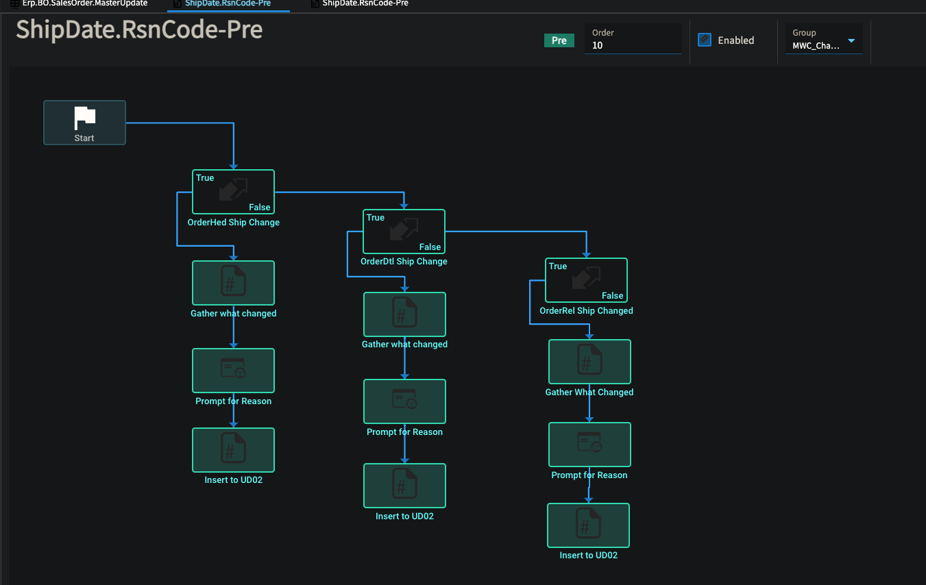

Just in case anyone else has this unique situation. Here’s how I was able to figure it out.
Here is the BPM Flow
First checking the OrderHed for a change, then OrderDtl, then finally OrderRel.

It gathers what changed (if anything) then asks the user for a reason, then logs that reason to UD02

I have the actual BPM attached if anyone does want to use it!
ShipDate.RsnCode-Pre.bpm (103.0 KB)
