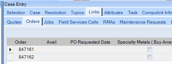

You can have one case and link any number of things to it. Quotes, Orders, Jobs, Field Service Calls, RMAs, Maintenance Requests.
Anything with the case number entered in it will show. I did not realize this until I had been using Epicor for ten years and found that HDCaseNum was on JobHead and all we needed to do we add the field to the screen.
