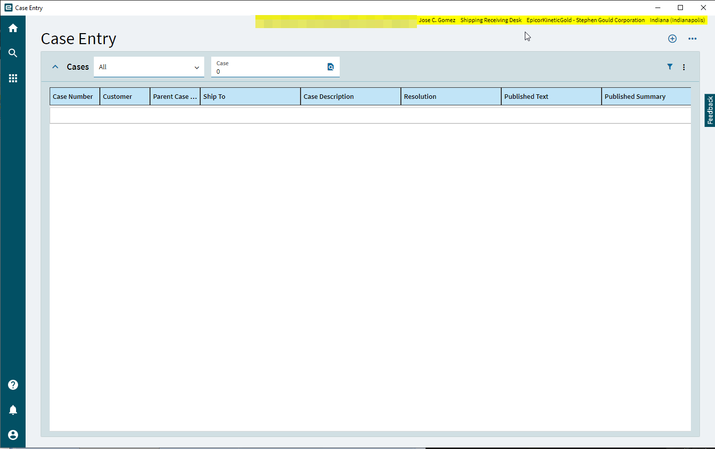

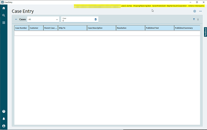

Case Entry shows up in 2021.2.3 (current SaaS version).

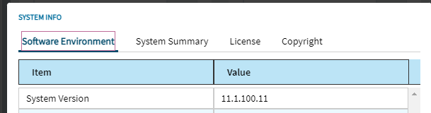

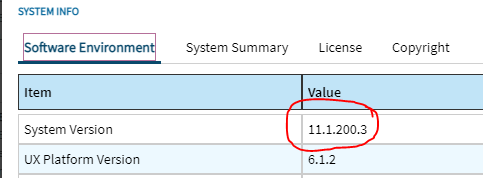

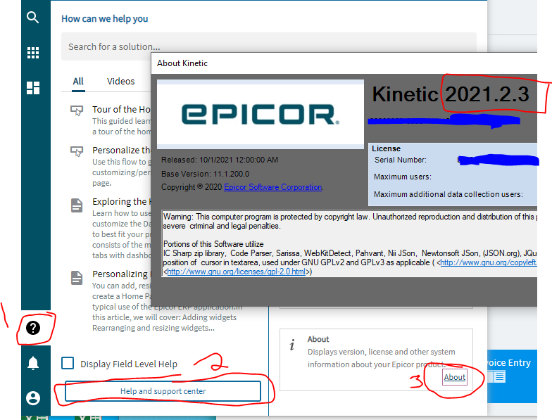

In Kinetic running on web browser, where do you find which version it actually is…? I know I can go back to Epicor Admin Console on the server, but where is Help - About hiding…?!
How do you check the version of Kinetic?
In browser, the verion nomenclature is a bit different:
In Smart Client this is the same version:
I think I have found it, the version installed is 2021.1.14
Ah thanks @BKen !

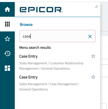

It’s in my version, which must be 2021.1.11 - make sure you’ve got the relevant menu security to be able to see it.

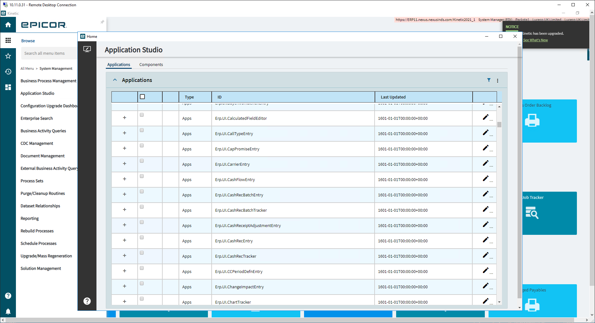

I have got it in the classic shell, but it is not in Application Studio.

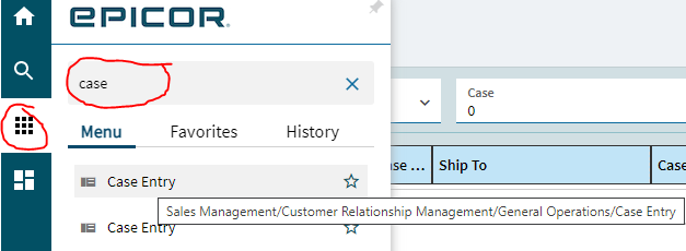

What are you typing in (the browser version) to search for the Case Entry module?
I typed Case in the the menu as you have got in the image, but when I go in to Application Studio there is no Case form.
that form has always been called HD Case for Help desk.
Try looking under H…
I don’t seem to have that either.
It’s called this:
Erp.UI.HelpDeskEntry
