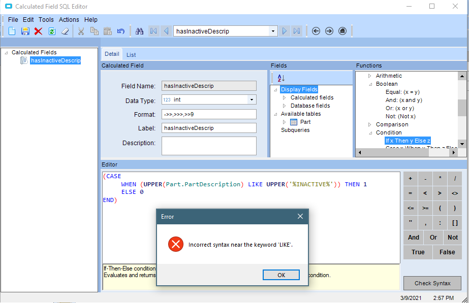

Our RMA team has to activate inactive parts so we can process the RMA(create a job), but that means they have to remember to inactivate the part after we are done processing the RMA. We decided to come up with a simple process to add the word “inactive” to the description and then create a monthly report showing all active parts with the work “inactive” in the description and corresponding open jobs so we have a reminder to inactivate these parts(and any we may have forgotten - no active jobs)…
So I need to create a BAQ that finds all active parts that will check if inactive is in the description, but I want it to be a case insensitive check. I think I need to do something like what is shown in the screenshot below, but this is resulting in an error. Any pointers?
Sorry to answer my own question. That statement worked, the error was coming from another LIKE statement, but since it showed up when I was defining the new calculated field I assumed that is what the error was referring to…

ERP database should have Case Insensitive and Accent Sensitive collation. It means that any string comparisons are case-insensitive on the SQL side.
At least, all ERP logic is implemented around that idea.
