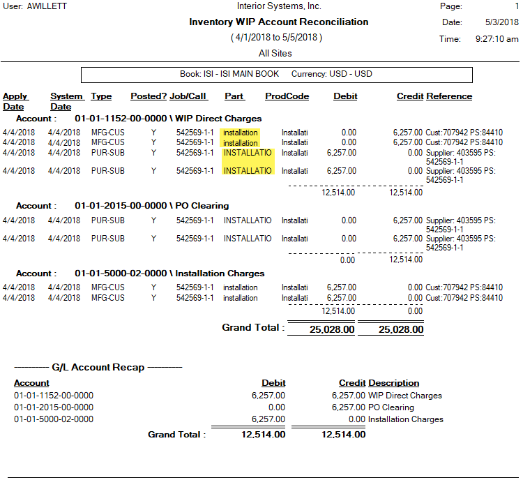

Is there a way to ignore the case of fields in the RDD? Or maybe it needs to be done in the join in SSRS?
I have a spot where one user used all caps and another used lowercase. The actual part is in all caps, so it looks like the RDD is seeing this as two different part numbers and is duplicating lines because of it.

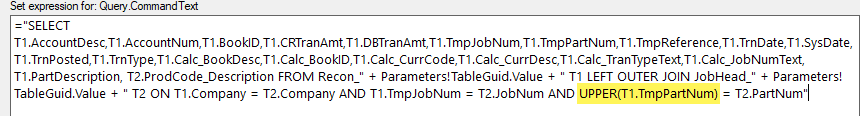

Deleting the relationship from the RDD (but keeping the table) and keeping the change in SSRS seemed to do the trick!
Glad you figured it out, when debugging double data that is outputted on a report, it’s most likely due to the relationships @ the RDD level. In some cases, you may need to modify the report style if you really need the relationship for a certain field.
Is there any point to adding relationships for the added tables at the RDD level if I can just do it all at the SSRS level?
I actually never tried setting up relationships @ the SSRS level without setting them up at the RDD level first. I’m gonna give it a try haha.
Yes. The table without the join is most likely populating all records from the database. The join in the RDD prevents that. The join in SSRS is against the reporting tables after the RDD does its thing.
