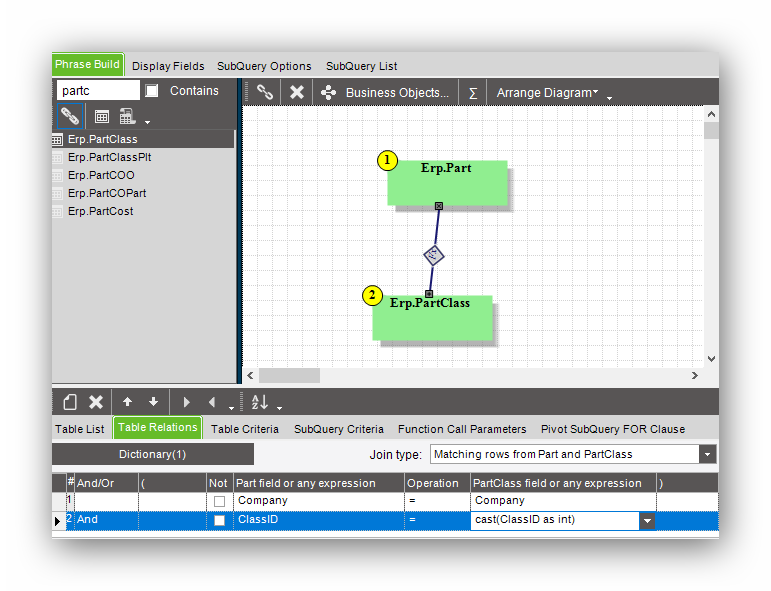

In SQL I can CAST/CONVERT the value to an int but how can I do this through a BAQ JOIN?
Thanks.
I’m an idiot!
I didn’t even try testing this.
Epicor knew what to do in the background so it must have automatically casted/converted the value for me.
One thing to be careful of is to make sure the nvarchar column will always contain a value that can be casted to an int. You can also specify the casts in the join conditions, so if the nvarchar column may contain a non-int, you can cast the int value to an nvarchar (the example below doesn’t really make sense, but it shows how to specify your own casts):
