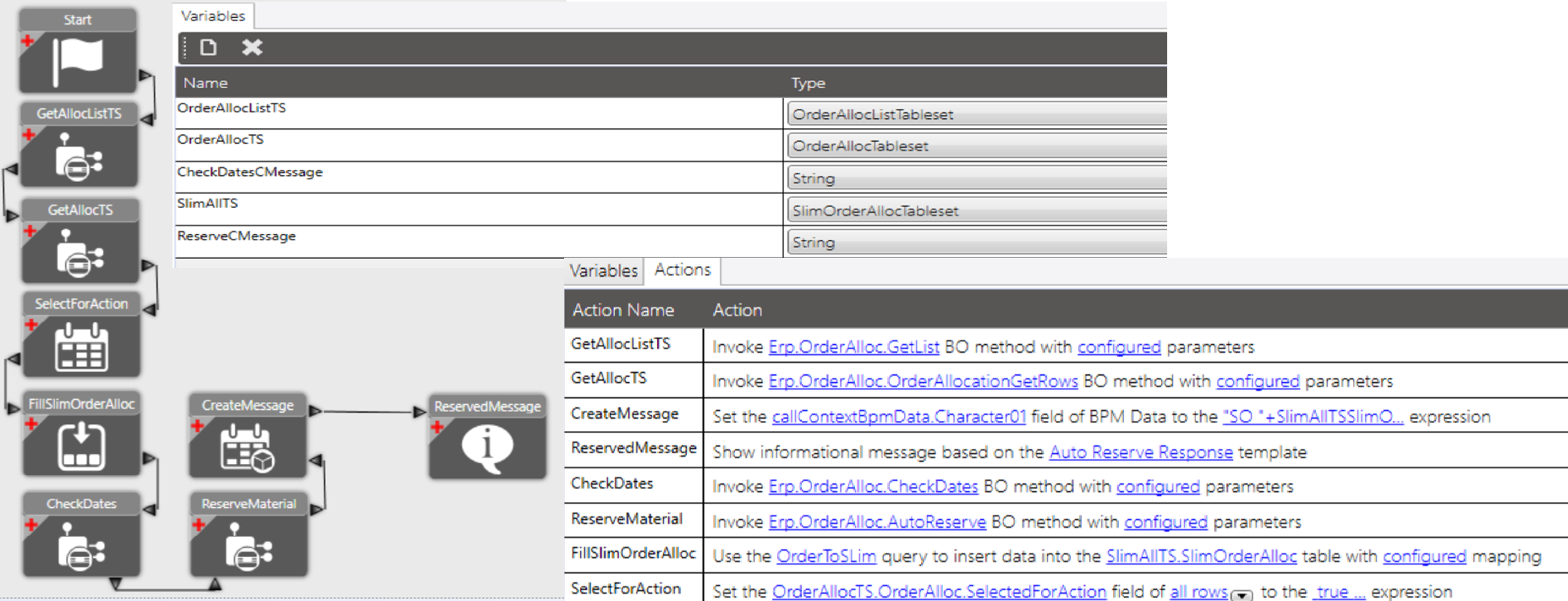

I need to add the preconditions so this triggers at the right point for us. However, here are the steps
  1. Setup variables. Here is my overall layout.
  1. Invoke BO OrderAlloc.GetList to get the OrderAllocList tableset.
  1. Invoke BO OrderAlloc.OrderAllocationGetRows to get OrderAlloc tableset from OrderAllocList Tableset.
  1. Flag SelectedForAction of all rows in OrderAlloc tableset
  2. Fill SlimOrderAlloc tableset from OrderAlloc tableset using fill table with query. Pass the display fields needed for the SlimOrderAlloc tableset.
  3. Invoke BO OrderAlloc.AutoReserve.
  1. Show message response from AutoReserve (cMesage Text)
Hope this help others trying to achieve the same thing.
