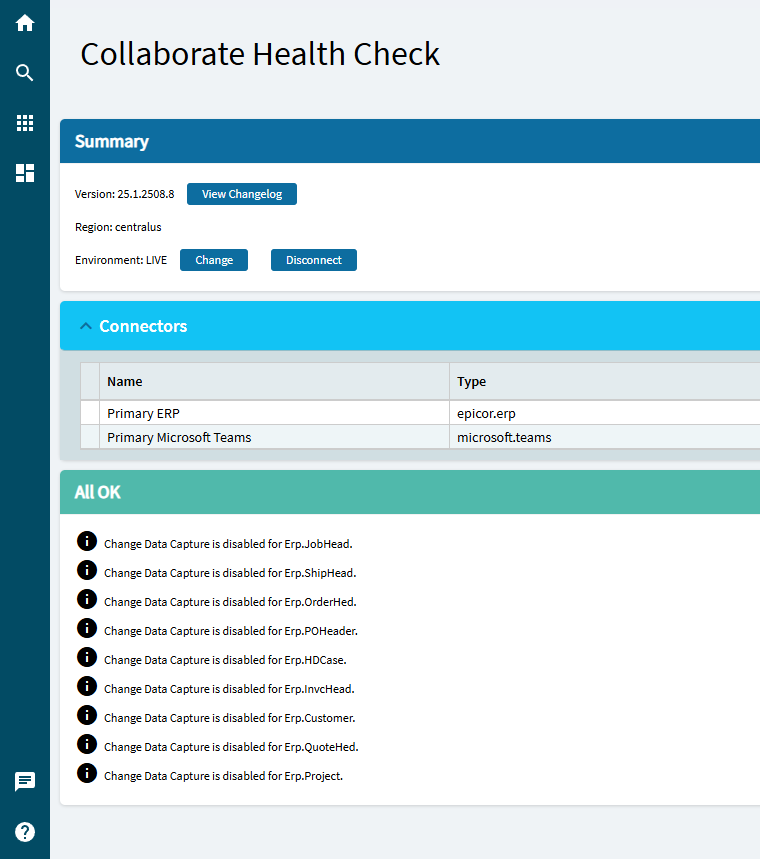

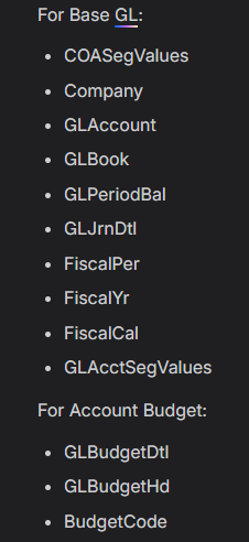

I’m being told by epicare these are the only tables they allow turning on CDC?
This is obviuosly wrong. Collaborate Notifications cannot event work with out this.
WTF is going on over there?

its on our invoice and it once worked in pilot - trying to get it up on live.

Just so you all know, I am aware of this and working with cloud operations. I make no promises or forward looking statements :slight_smile:
What I can say is it is a historical concern about two things:
  1. customers turning on table tracking but not scheduling the CDC Processes can result in extreme bloat in the CDC.CaptureLogTable
  2. Although most do not notice or don’t care, CDC tracking is handled by DB triggers and there is a performance cost for enabling it. I don’t have exact numbers because it will very but it can add as much as 5-7% to CrUD operation (no cost for read of course).
