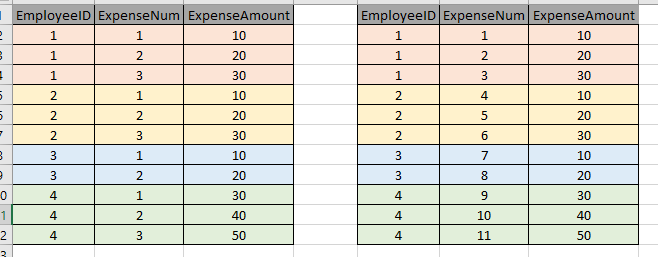

We want to do mass import employee expense to Epicor, if I use DMT or updatable dashboard, I have to know each employee expense number. because in Epicor, it is required to be sequentially and continuously, it is hard to search each employee expense number.
I am just thinking may be if I change data type from INT to nvarchar, then it is not necessarily to make expense number continuously.
For example, now in Epicor. the expense number is generated auto-increment for each employee level, I want to make it on company level.

Left image is Epicor logic now, Right side is the goal I want.
Is any idea how I could accomplish it?

Dear Xiaoting Geng,
The way Epicor processes table key numbers is central to proper software processing of transactions. However, you can easily create a UD field (or in E9 use one of the already-available user fields) to contain your user information; then you can use the numbers for whatever purpose you need.
