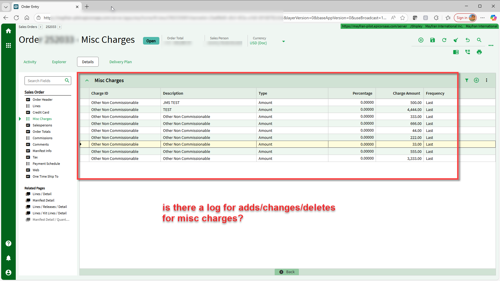

Does anyone know if there is a change log available for Misc Charges? (on the order header or line items). I have been tasked with creating one. They want a history of all adds/deletes/changes to these entries.

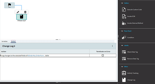

Correct, so create a Data Directive on OrderMsc, pick which fields you want to track in the Change Log:

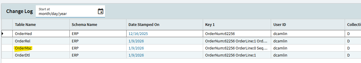

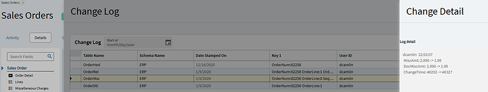

I can then see the changes in Order Entry’s ChangeLog:

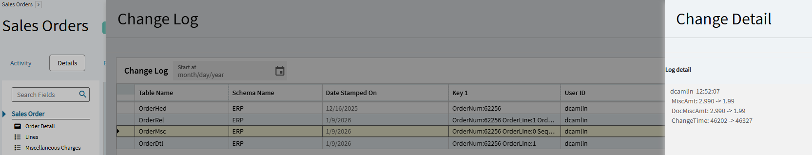

Click into that entry and see what changed (assuming they were changes to the fields you pre-selected in the DD).
The log text details the before & after state of each field that was changed.

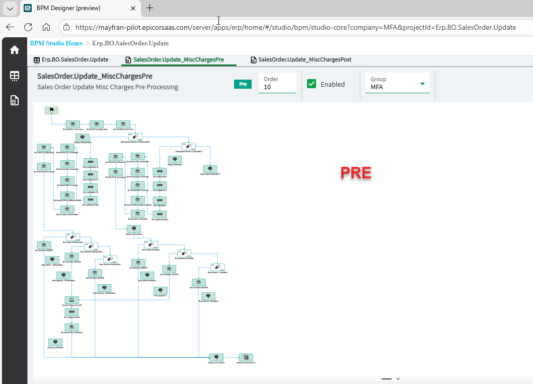

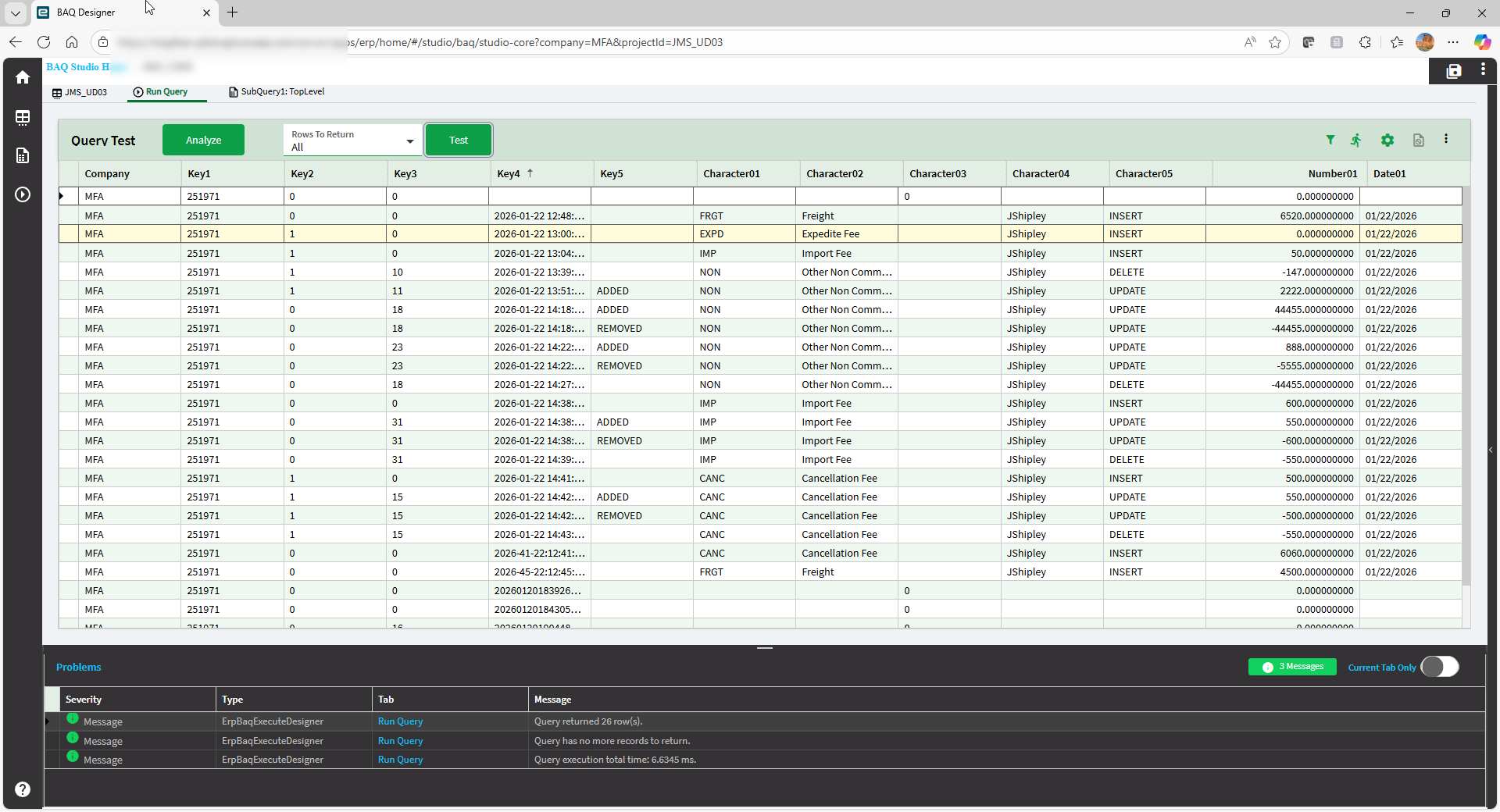

OK well I think I finished this project. It seems to be working but I’ll have to hammer some more data in to make sure it is correctly doing what we want. As I said above we wanted a history of adds, deletes and updates to miscellaneous charges - both on the order header and order line items. We used to do this with a trigger on OrderMsc back when we were ON PREM! But alas now we are in the cloud so it’s harder.

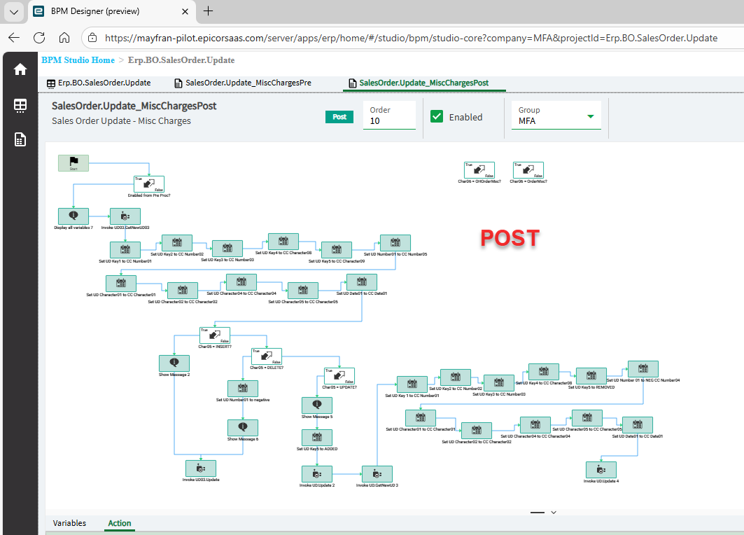

This was more tricky because you have inserts/deletes/updates from OHOrderMsc and OrderMsc so there is a lot of branching. I am (or was) pretty new at BPMs so I had to start real basic and build it up using lots of messages showing the interim data. I used the SalesOrder.Update method and a pre and post directive. The pre processing directive sets most of the call context variables. The post feeds them into the UD03.Update method several ways.
I am wondering if this is usually how people build these things - there is a ton of widgets, so no code really. It seems to work though.

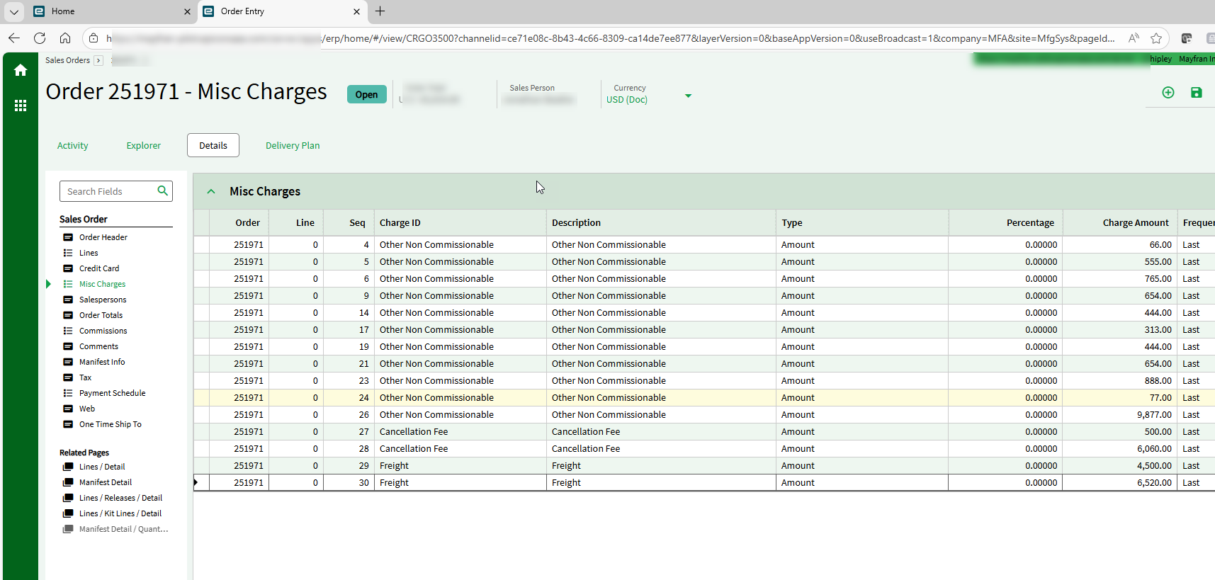

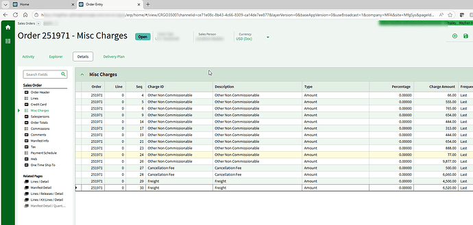

Some sample misc charges on the order header:

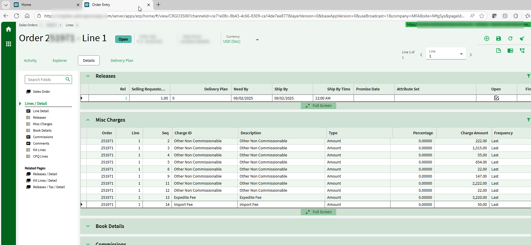

More misc charges on the line item:
The Pre processing directive:
The Post:

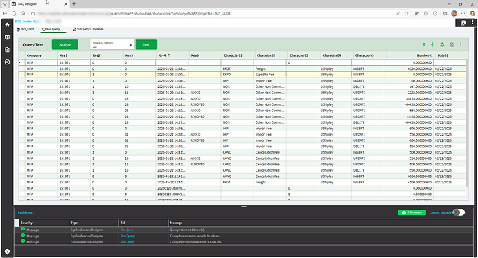

And the results from a BAQ:
Anyways, just thought I would follow up and show how I did it.
