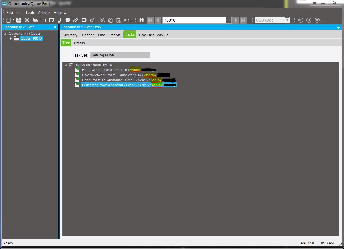

So is there a way to capture the the name of the person that is shown in the tasks?
 ![task1](https://epiusers.help/uploads/default/original/2X/7/7f66a9ba6b04199a0feba98b98335e83326cb9f4.JPG)

You might try a post processing BPM on GetNewQuoteHed that passes the new quote num into a variable from the pre-processing. From there, in your post processing, call code to set a custom field that you’ll want to create, otherwise you can use the quote comment field or something. You’ll set the field equal to the Session.UserID string.
See this post, because it’s very similar. [BPM to set the value in a dropdown on Quote Header - #3 by Aaron\_Moreng - ERP 10 - Epicor User Help Forum](https://epiusers.help/t/bpm-to-set-the-value-in-a-dropdown-on-quote-header/43765/3)
