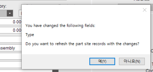

We intend to change some FG (products) from outsourcing production to goods that are purchased and sold by business process change.
After changing the Type from Manufactured to Purchased in Part management, is there any other work?
Will there be any other problems if I change the type of the existing part number?(Costing Method is STD)
Check the sites on the part as well. You will want to make sure it’s set to purchased there.
If you enter any kind of burden for purchased goods, you will want to add that as well.
As you said, a pop-up to check the site appears.
There doesn’t seem to be any problem with changing the part type like this. Because STD cost is used, there seems to be no cost problem.
Thanks for your advice.
