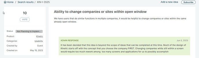

Did anybody else notice you can now switch companies AND sites without going back to the home page first?!?!? I haven’t seen anybody else post about this Epicor miracle? We have been begging for this functionality for literal decades and its finally here. Kind of amazing there was no announcement about it and every “idea” I ever entered got marked not planning to implement. Yet here it is.

You are correct that this feature was added. While it was in an “idea” the idea never was properly connected to the EPIC that enhanced the feature, so therefore notificaitons were lost.
I have marked the two ideas that I found out there as Delivered. (one expired, one still open).
