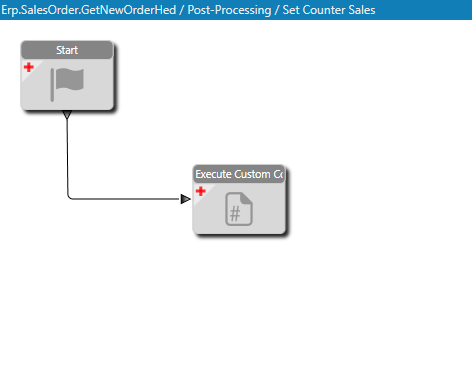

here is the bpm you have to go.
Erp.SalesOrder.GetNewOrderHed
var ttOrderHedRow = ds.OrderHed.Where(O => O.Added()).FirstOrDefault();
if(ttOrderHedRow != null)
  ttOrderHedRow.CounterSale = true;
